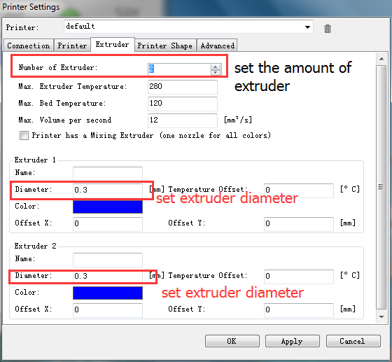

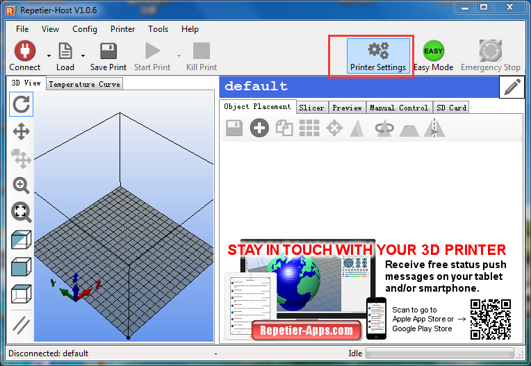

Open Repetier-Host 1.0.6, access "Printer Settings":
Set the amount of extruder, so that you can heat up both extruders in Repetier:
But that's not enough, if you want boths extruder work when printing, you need to have correct slicer setting:

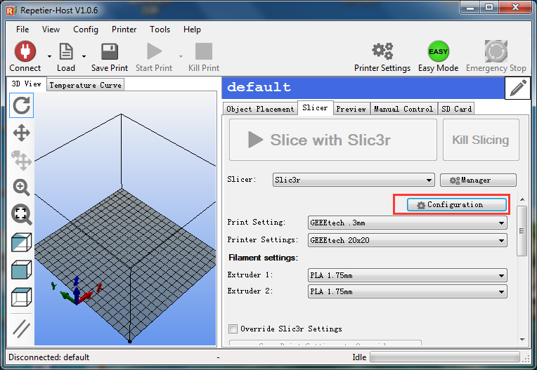

Access "configuration" to set slicing:
You can download this file to set it:
slicer settings for I3C.zip
