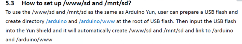

You can refer to this page:
http://www.geeetech.com/wiki/index.php/ ... nt.2Fsd.3F
how to set iduino.png (80.5 KiB) Viewed 6130 times
