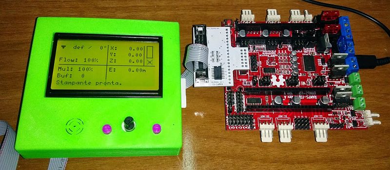

I am trying only works with Repetier-Firmware
But it does not work with Marlin Firmware
You represent work with Marlin Firmware I need to work
with Marlin Firmware options because it does not have multi color Repetier-Firmware
- Ramps-FD_Arduino_Due_LCD_Repetier-Firmware.jpg (74.7 KiB) Viewed 19141 times

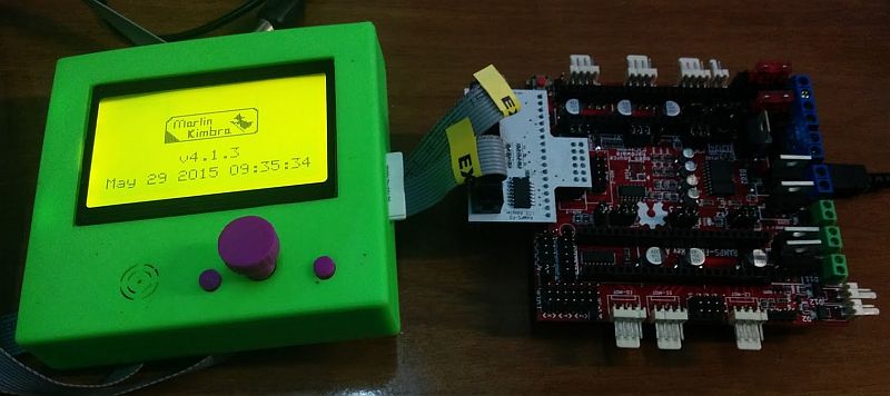

Contacting the programmer MarlinKimba http://marlinkimbra.it/
And we are doing various tests we have solved
Probably 74hc4050D on the LCD module is too slow
Arduino DUE you should use a component faster
for now slowing the writing on the LCD and SD works
In Italiano
Contattando il programmatore di MarlinKimba http://marlinkimbra.it/
E facendo varie prove abbiamo risolto
Probabilmente 74hc4050D presente sul modulo LCD è troppo lento per Arduino DUE si dovrebbe usare un componente piu veloce
Per ora rallentando la scrittura sul LCD e SD Funziona
In Italiano
- Ramps_FD_MarlinKimbaOK.jpg (44.21 KiB) Viewed 19123 times
