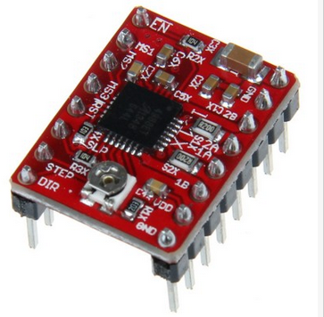

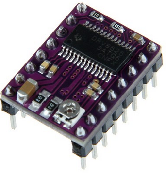

Usually, the voltage between screw on driver and GND is around 1V or 0.9V. That's enough.
You should be happy that the extruder motor is not hot.
This is A4988
This is DRV8825
You can see one of their differences is in the positon of screw.
