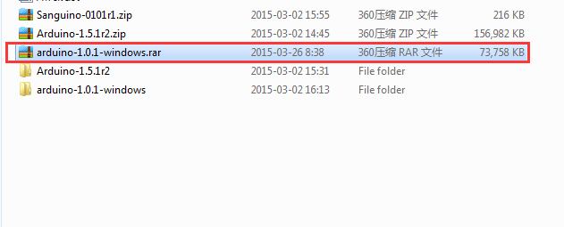

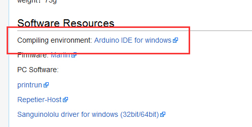

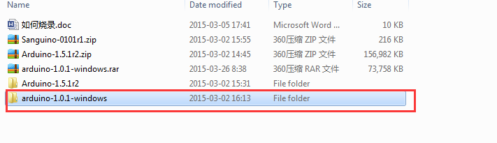

1. Download arduino 1.0.1,
download link: http://www.geeetech.com/wiki/index.php ... Resources
download arduino.png (15.79 KiB) Viewed 99821 times
Unzip the file.
unzip arduino.png (18.85 KiB) Viewed 99821 times

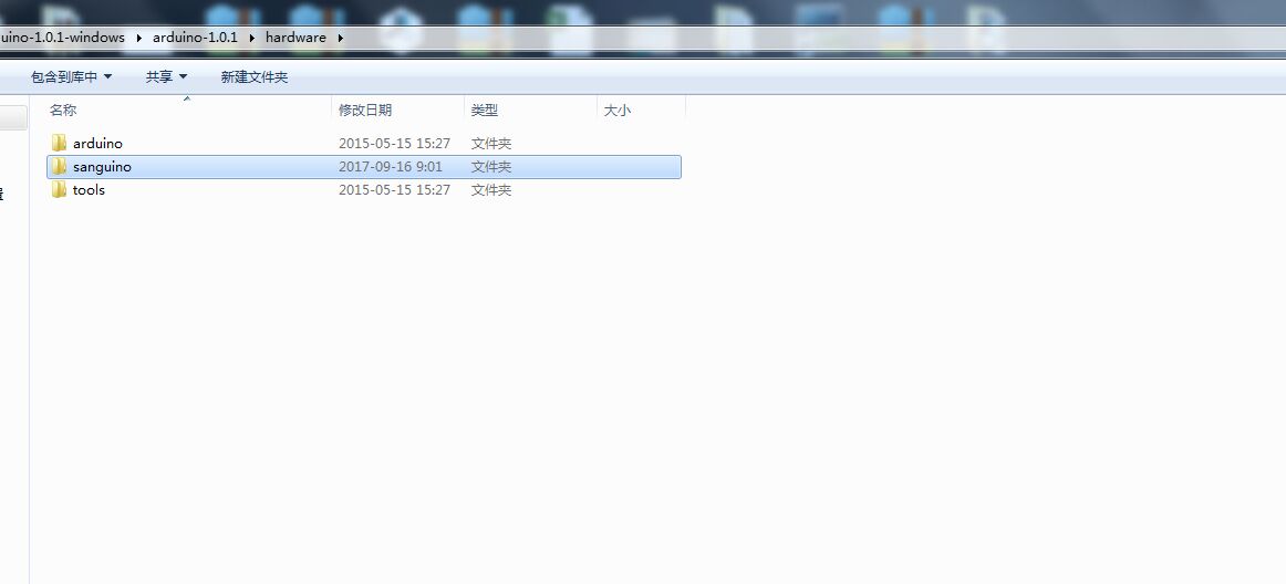

For sanguinololu, you need to copy the folder named "sanguino" to the folder "hardware" of Arduino IDE.
The "sanguino" folder:
sanguino.zip
(209.25 KiB) Downloaded 3019 times
Download this file and unzip it and move it to the folder "hardware".
1 for sanguinololy.jpg (34.93 KiB) Viewed 79250 times

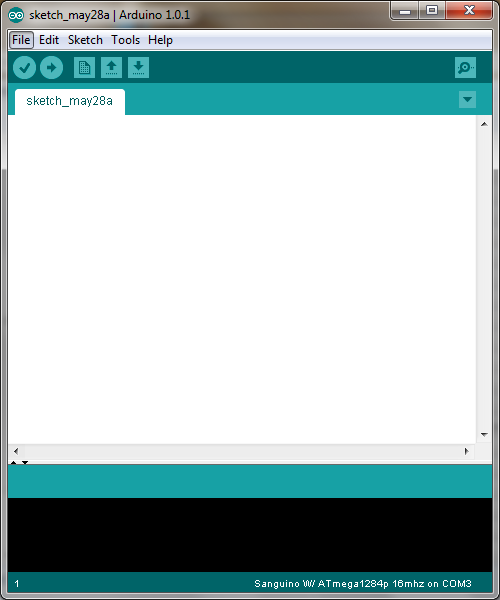

2. Connect your printer to computer, open "arduino.exe".(There is no content in arduino when you open it, if not, delete the content)
open arduino.png (27.83 KiB) Viewed 99821 times

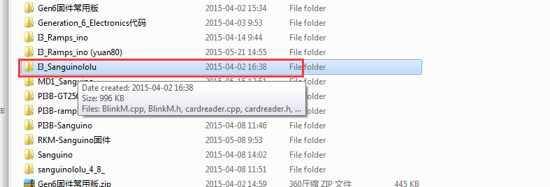

3. Here take firmware "I3_Sanguinololu" for example.
for GT2560, you can also come to here to install the firmware:
viewtopic.php?f=13&t=17181

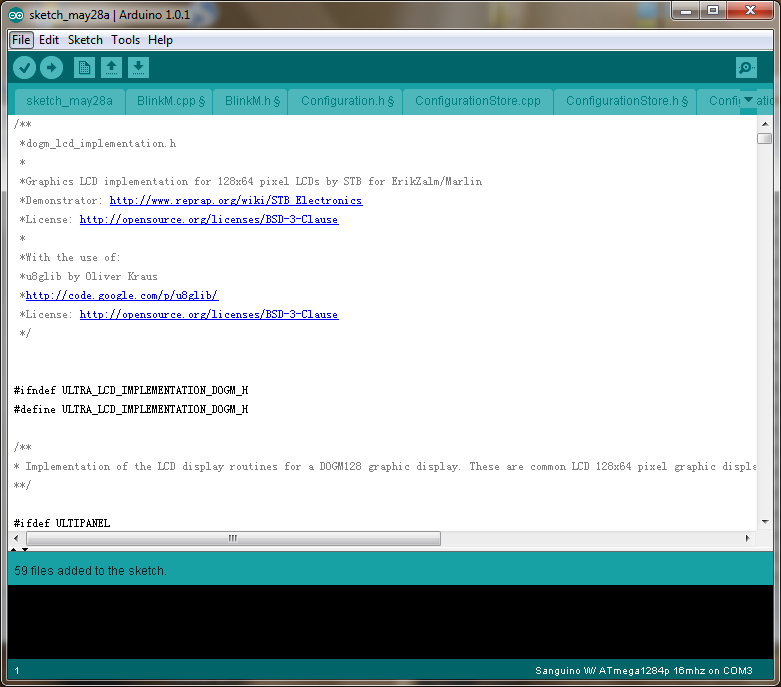

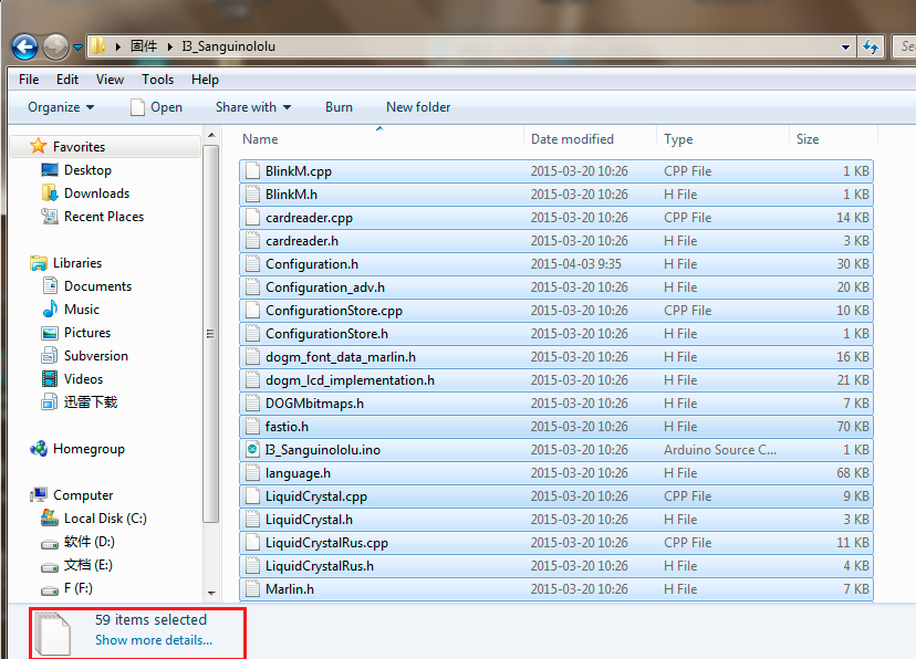

Open folder "I3_Sanguinololu"(files of Marlin firmware), double click the "XXX.ino" file to open the firmware in the arduino.
If you can't find the .ino file, then select all the files (59 in all) and drag them into arduino.
open sanguino.png (34.28 KiB) Viewed 99821 times
select files.png (135.59 KiB) Viewed 99821 times
drag files into arduino.png (49.14 KiB) Viewed 99821 times

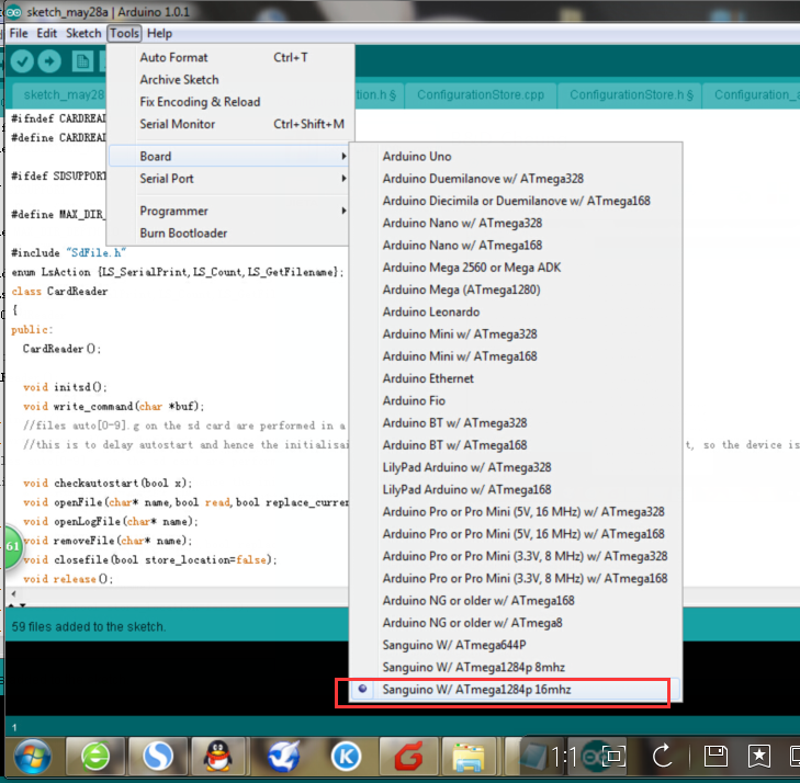

4. Choose correct board type.(Tools>Board>Sanguino W/ATmega1284p 16mhz) (If you use GT2560, choose "Arduino Mega2560 or MegaADK")
choose board type.png (325.37 KiB) Viewed 99821 times

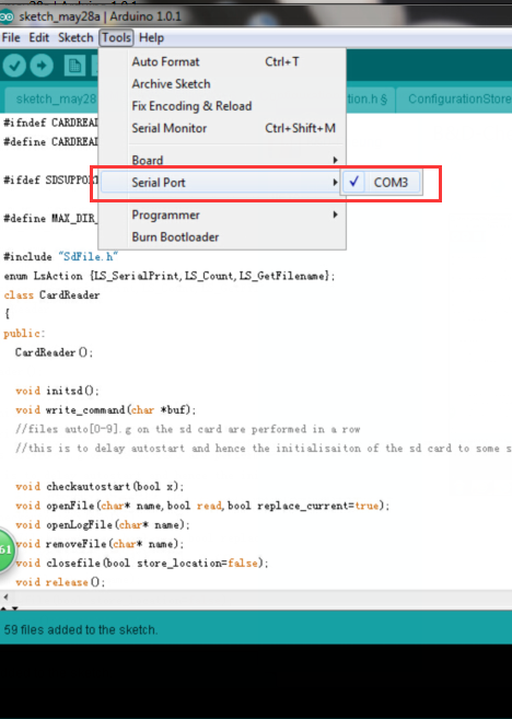

5. Choose correct serial port.(Tools>Serial Port>...(Usually only one choice for Windows)).
choose port.png (137.49 KiB) Viewed 99821 times

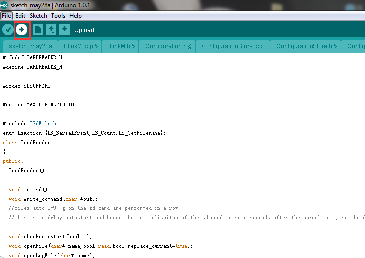

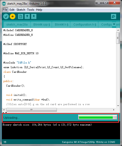

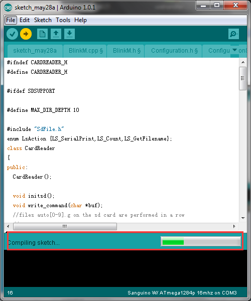

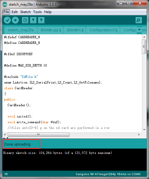

6. Click the icon "→" to upload the firmware to your mainboard.
waiting for compling and uploading.
7. When displaying "Done uploading", you have successfully uploaded the firmware to your mainboard.
done uploading.png (34.96 KiB) Viewed 99821 times
