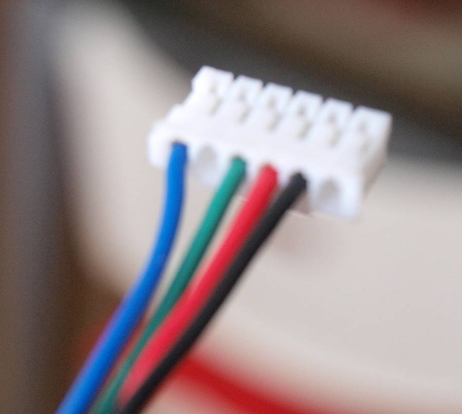

having performed a complete differential diagnosis, I am proud to present you the defective part. It was a crimping issue on one of the cables, as can be seen in the attached image. So, I now need a new cable; which, I of course expect to be shipped ASAP. You have my address via Aliexpress, so its 12h again (see below as for why).

Picture of wrongly crimped cable. This seems to be a common error, maybe your supplier was tired.
Fortunately, here is the repair instruction. When looking at the silver part of the cable from the top, you will see something which looks a bit like an erected hook which blocks the cable from being pulled back. Push this down with a small screwdriver, and retract the black cable. Then, move it one slot to the right.

Hi, we are sorry for sending you a bad motor wire, but you can re-position the black wire yourself, have you solved this issue?

Re the cable: I was able to recrimp it to some extent, but would prefer a new cable. Altough, in fact, I would now already prefer a different printer with a different process computer. The printer is in my lab for almost a month now and it still doesnt work.
