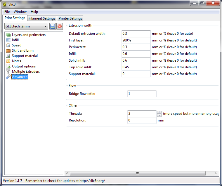

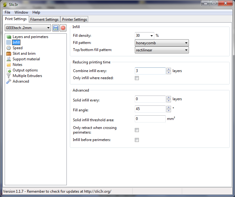

I see the infill is not so good, I am afraid it can not hold the extruder so long, what value did you set? I think for such a part, it needs higher infill, 30% fill density is no problem.
You can refer to the infill part.

Thank you for the screen shots. I think I had infill at 40 or 50%. Never looked at the advanced setting.
Problem with these step type prints is unless you count which layer is the top one of the bottom step it does not give a solid layer. Only bottom and top as far as I can see.
I have on order angle aluminium 50 x 25 x 3mm, cost about $7, which I will mount the holder on.
It would take a lot of weight and heat to move that....
