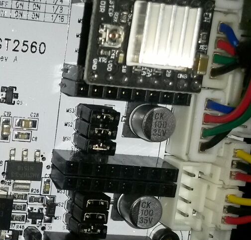

hi ,you try to check the subdivision of stepper motor.
- the subdivision of stepper motor
- 2-2.jpg (27.31 KiB) Viewed 24114 times
Re: Extruder Motor Not working...
My is jumper inside....Being check , all okEric wrote:hi ,you try to check the subdivision of stepper motor.
- 2015-07-04 13.43.11.jpg (228.12 KiB) Viewed 24107 times
