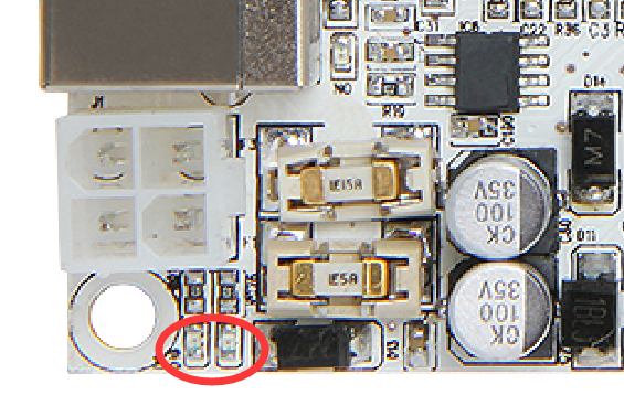

when you turn on power,could the psu power up the main board.please check the lights of fuse and send me the picture of mianboard when powering up.

please check the psu.the output woltage is 12V.
when powering up,the led marked by the red circlie would be light up .
please see the picture.
