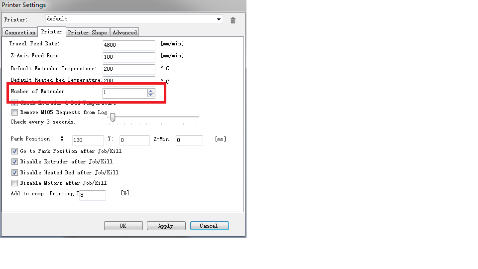

Extruder motor does not run while printing. Host choice only indicates Extruder 1 available but host command line says Extruder 0 is activated.
How can I change that?
Mark
Posts: 1553
Re: Mini G2 Firmware values
Post by Mark »
LENNS, did you set the number of extruder on your host? see as pic below:
And your motor is not working ,did the motor wires are well contacted?
Or could the motor run without fliament? maybe it is too tight between fliament and the screw ,try to adjust the screw on the extruder to see if it works .
