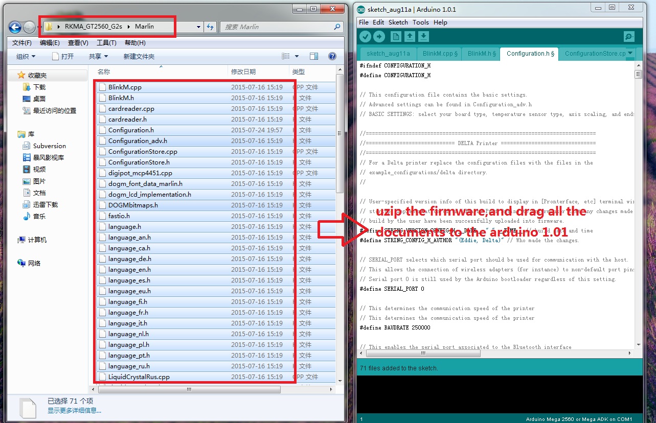

How are you getting the file to open in arduino I don't think my board came with any firmware on it but I found this file you posted but it will not load into arduino
you can do it as follows:uzip your firmware ,and drag all the fires in it into the arduino1.01.
