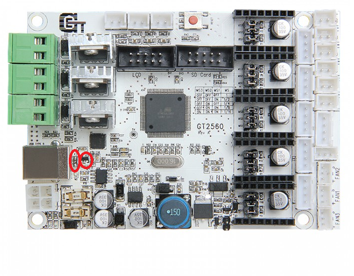

what' the type of your main board,ii it gt2560(refer to the attachment)? ,i think you may connect the heating wire of extruder to hot bed ,so LCD shows the ERR MAXTEMP BED.the wire connection please refer to the folowing link.
http://www.geeetech.com/wiki/index.php/GT2560

According to this image
I have done all my wiring correct but i still get a bed temp error

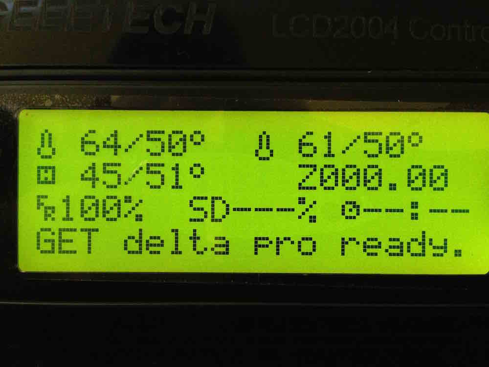

Hi Everyone,
I am new to this forum and this is my first post. I have read everything I found on the "Err: MAXTEMP BED" error and I have checked the wiring and everything looks correct and I can see any short anywhere, is there anything else I should do to get rid of this error?
However when I unplugged the thermistor from the board I could get to the message "GET delta pro ready", does this mean that my thermistor is not working?

you can check the thermistor wire and its extension cord were bad contact or not;Hi Everyone,
Regards,
Rick
If its ok,you can swap the hotbed thermistor sensor with the hotend one to make sure the sensor is dead or not.
Or you can reburn your firmware to try again.

Mark, your suggestions were very good and correct, I shall explain (for anyone else who may be interested).
I received the disassembled the hotbed and removed the thermistor and found that the thermistor was incorrectly installed in that the wires were shorting out. So using a magnifying glass I verified what that the thermistor legs were actually separated and then taped down with new Kapton tape and then reconnected everything to find that it the temperature was now being displayed and the hotbed actually started to work.
I thank you and also Melody from Geeetech who really stayed with me and provided me with helpful support and information.
Now I just need to work our why my motors erratically send my extrusion heads all over the place and continuously bang into the hotbed.
Regards, Rick
