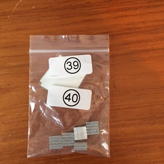

I didn't find any instructions for what to do with parts 39 and 40 the small heat sinks. Where do they need to be installed?
Heat Sinks parts 39 and 40

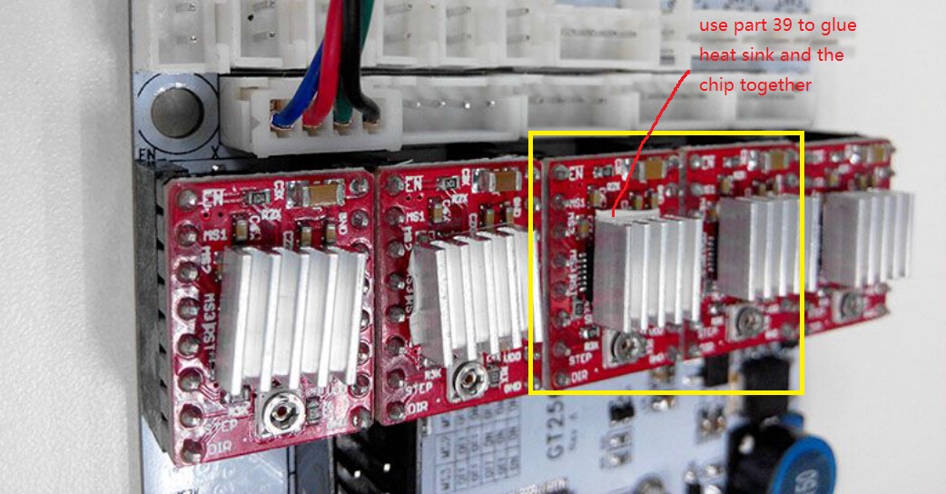

Using like this~~

You cut one of the sheets into pieces to stick on the back of the heatsinks and then you fix the heatsinks to the top of the motor drivers.
Note the plastic sheet is double sided tape.
