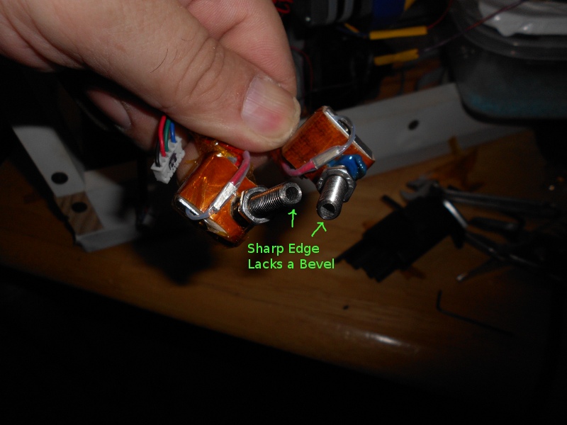

2. The 3mm extruder throat does not have a beveled ID at the entry point, so the filament rubs the edge and it WILL Stall once things get warm.

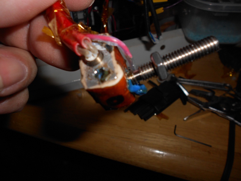

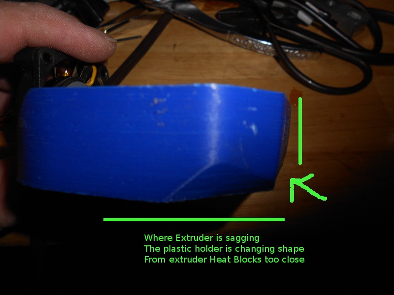

- See what is happening because the way Geeetech ships the hot is is 180 deg wrong
- Why-Extruders-are-sagging.JPG (128.83 KiB) Viewed 14191 times

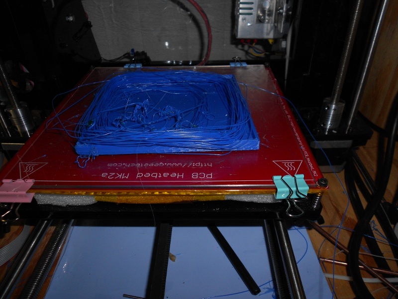

- This is what happens after the stall
- typical-build-fail.JPG (148.85 KiB) Viewed 14191 times

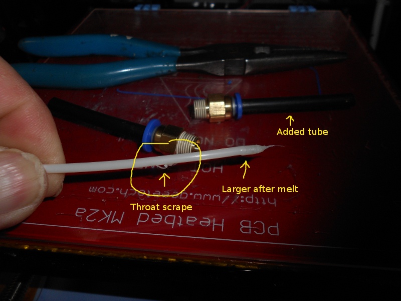

- See the gouge as the larger gear and throat with no bevel does? I also added the tubes, but it did not help.
- throat-scrape+added-tubs.JPG (130.51 KiB) Viewed 14191 times

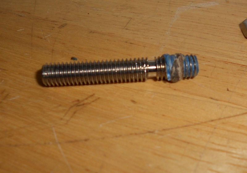

- Thsi happened because the throat was not deep enough into the heat block. I could see the set screw when I took off the extruder nozzle
- throat-block-out-of-adj.JPG (118.97 KiB) Viewed 14191 times
- See, no bevel.... Hummmmm Geat machining you guys.... NOT
- sharp-edge-throat.JPG (115.85 KiB) Viewed 14191 times
- This is what happen when ithere is a gap between the nozzle to throat
- hot-ends.JPG (118.97 KiB) Viewed 14191 times

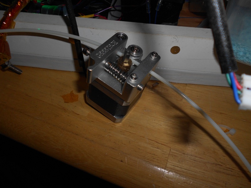

- I tested the motor without any other parts. When I put the throat in, I could clealy see ithe gear is too larger for 3mm
- Extruder-Motor-Stall-Test.JPG (127.2 KiB) Viewed 14191 times
- It will nevet go back together without some major effort. I heated it up to take it apart, now I have the burns on my fingers to remind me or the workmenship
- damaged-throat.JPG (117.43 KiB) Viewed 14191 times

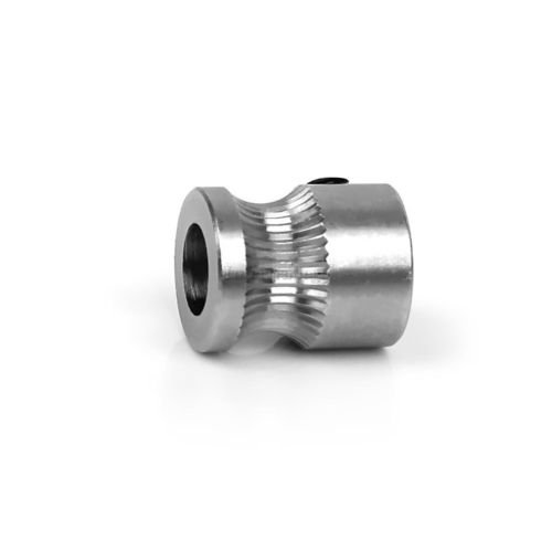

- Here is the gear that should be on the MK8 when setup at 3mm with a 10.5mm dia.
- MK8-3mm-Extruder-Gear.JPG (8.64 KiB) Viewed 14191 times
