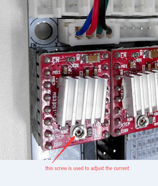

Some time left motor higt 10mm right motor higt 20mm not equal when run quickly
How can i do ?
Some time left not move right move
Used a4988 chip
Thanks

Looks like your motor is out of step. you can adjust the current of your motor to see if it works, generally it arranged from 0.8-1.5A.
the way to adjust is as the pic shows:
driver current.jpg (304.26 KiB) Viewed 5482 times
