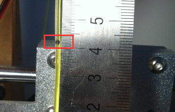

It is normal that the dimension of the printed objects has an offset within 0.3mm. What's the offset of your Z axis?
And you can make a mark on the filament, and manual ectrude 10mm, measure the actual extrude length to see if it is 10mm.
If not you can change the DEFAULT_AXIS_STEPS_PER_UNIT according to the actual length and calculate the real steps.
