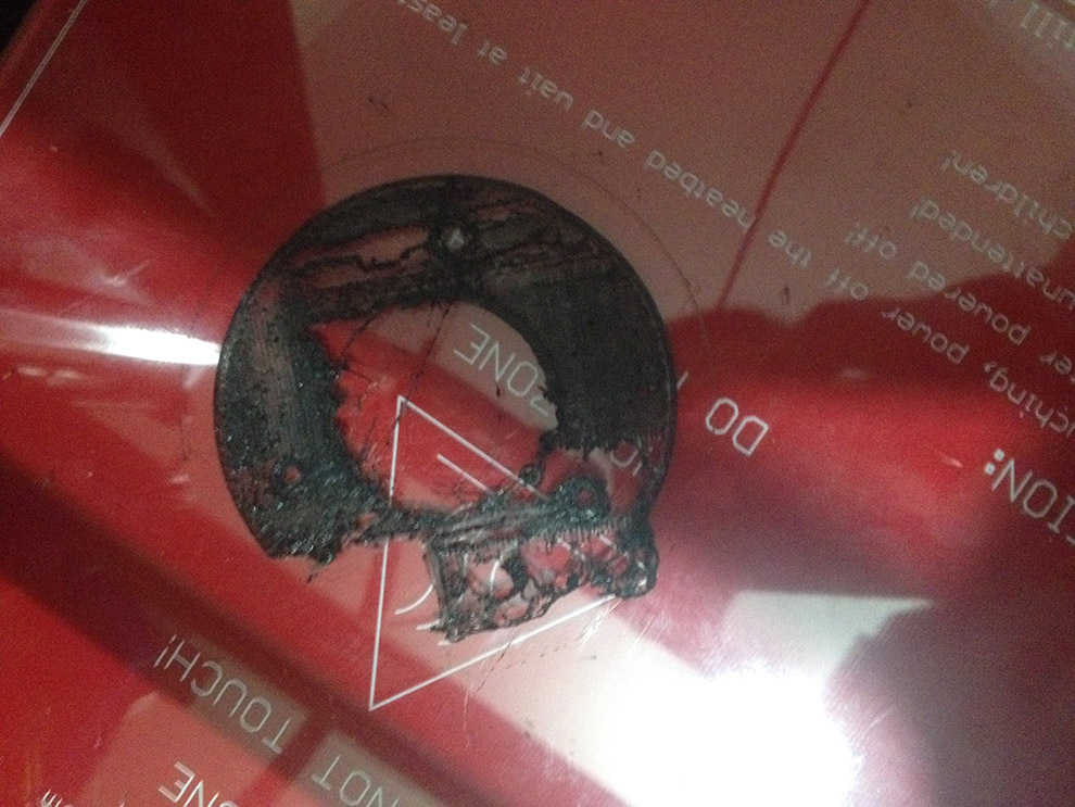

Do you have a pic about it ?
Re: Heigth of Extruder 0 and 1
Here is the pic.

- IMG_2059.jpg (215.55 KiB) Viewed 9134 times

The first layer is not stick well to the bed. maybe is the problem.
And it seems that the filament is burned black, what's the temperature you set for the extruder?

When i purchased the kit, i especified that i want black PLA; but it seems (by the experiments with temperatures) that sended ABS filament.
When i try with PLA settings, the temperature was 215° in the extruder and 60° in the bed.
When i try with ABS settings, the temperatura was 245° in the extuder and 100° in the bed.
I want to make a note: I discovered that it was two nuts to adjust the height of the extruders, i adjusted about 1 mm upper the second one to get this.
