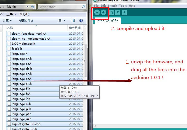

Hello, I purchased a Geeetech Latest Unassembled Acrylic I3 Pro C dual extruder MK8 3D printer DIY and am having problems with the original firmware. Can you please send me this and a basic instruction on how to reinstall. Thank you
Y
Mark
Posts: 1553
Re: Need firmware an settings
Post by Mark »
reburn the firmware as the pic shows:
Marlin_GT2560-PI3_Pro_C.zip
(299.21 KiB) Downloaded 556 times
