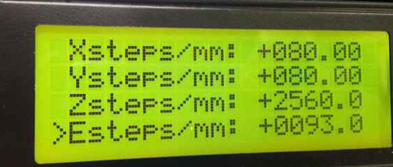

But you can change settings as the pic shows, adjust X,Y,Z axis steps per mm to find out the appropriate steps.

2560 is that correct. I put it in the firmware and burned it. My printer did not like it at all. It would not even home.

Did you change any others settings? Generally change the X Y Z axis steps will not cause the home problem.

Thanks mark. I have solved a couple of issues i had after assembly. the first was the temp probe for the hotend would move in and out. Regular heatsink paste worked well to fill the gap. it dries and get crusty and holds the temp sensor in nicely. another is epoxy. i busted the spider several times and epoxy worked well to get me close enough to print a new one. you told me to change the steps per mm but that caused my z motor to grind when homing. i am not sure what that causes. i am using the repetier firmware you provide. if you can send me another i will try it and see if it fixes my prints being too large.
