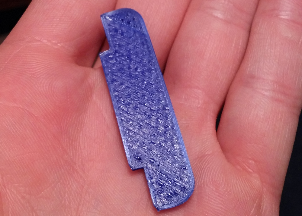

first layer
first layer
This the first layer, as you can see the extruder is a bit far from the bed this is on purpose because otherwise at the upper layers the extruder is so close to the printed model that it actually moving the model on the bed.

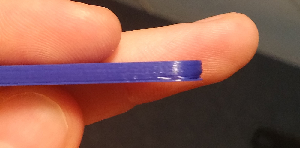

last layer
last layer
last layer
last layer
last layer, as you can see at the last layer the extruder is already too close to the model
(hope you can see what I mean)

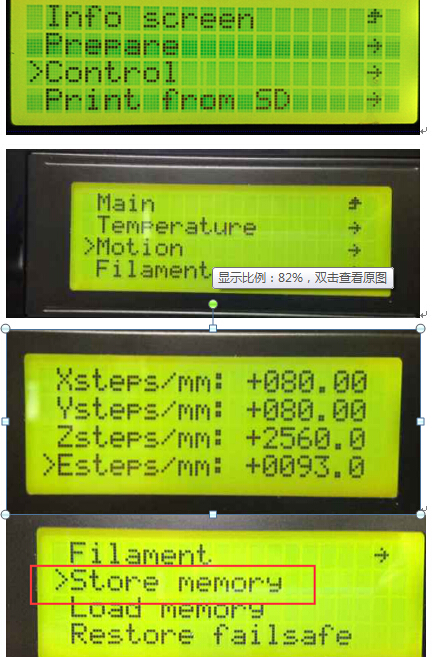

Whats the temperature and material do you use?
And you can make a mark on the rod, and manually move the Z axis up 10mm, measure the actual distance it moved, compare those two numbers and set a proper number for the Z axis step per mm here(remember to save the memory!):

ok so after playing with slicer's settings and set the extruder's temp to 210C now the result is much better!
but now something is weird with the second layer, the seconded layer is messed up time after time

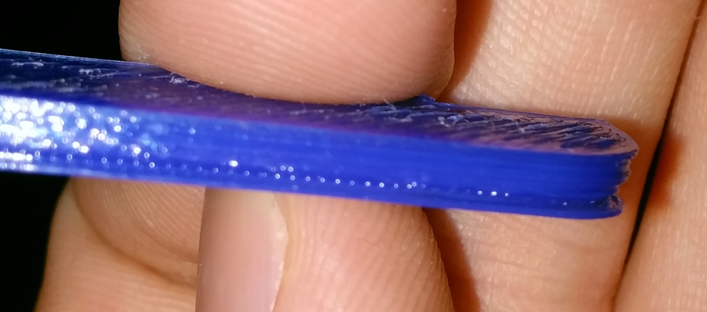

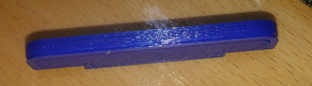

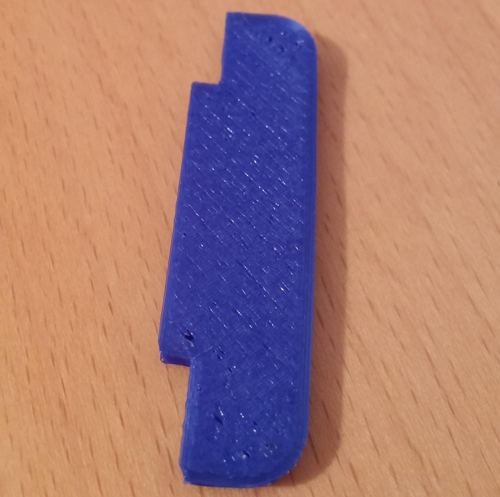

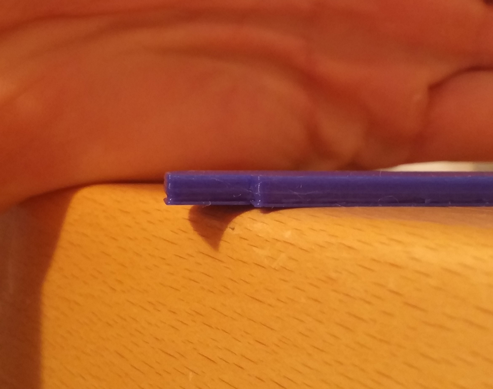

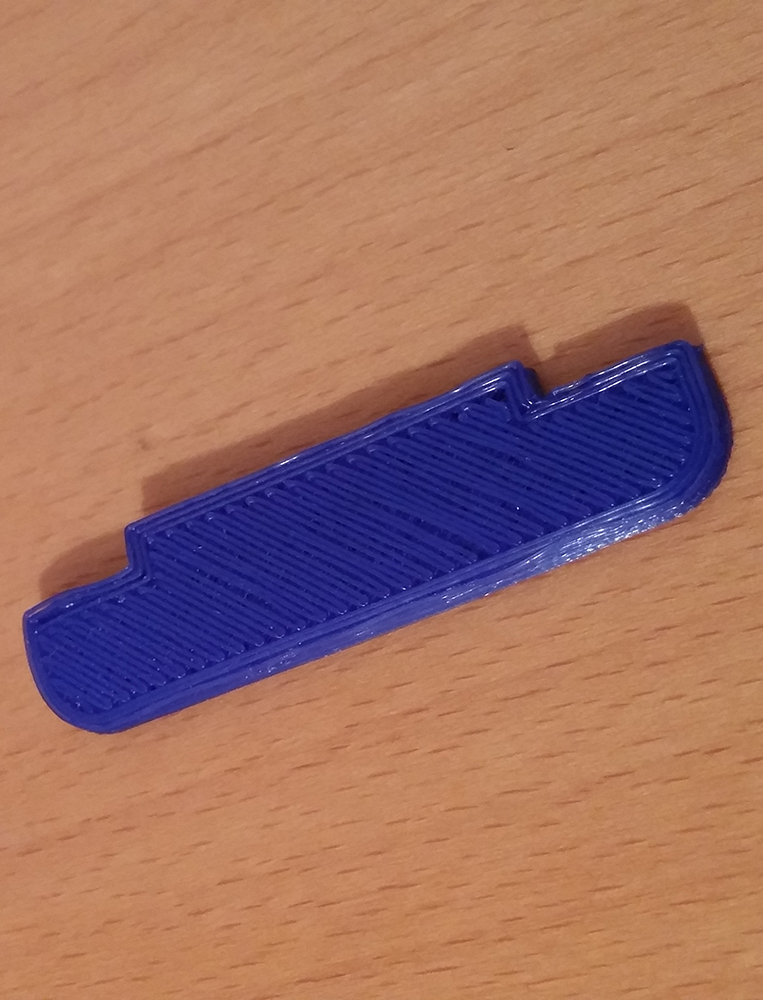

2015-09-15 19.48.02.jpg (196.91 KiB) Viewed 12561 times
2015-09-15 18.23.55.jpg (341.29 KiB) Viewed 12561 times
2015-09-15 18.22.04.jpg (266.44 KiB) Viewed 12561 times
2015-09-11 13.09.10.jpg (271.26 KiB) Viewed 12561 times
Do you know what is wrong and how to fix it?
