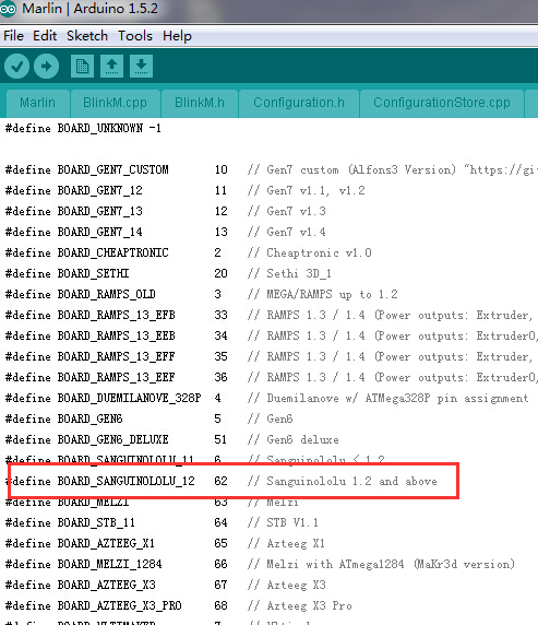

You can choose the board number 62 according to the board.h tab of your firmware.

Thanks Mark did that but now my x axis is no longer moving.

By increasing the power to the step motors (by turning the small screw on the drive connected to the sanguinololu ver 1.3a board) it seems to have fix my z home issue.
But now I can not jog the z axis using repeater-host. Only one step motor turns and the other one just tries but does not turn...
Any ideas?

#define MOTHERBOARD BOARD_SANGUINOLOLU_12
