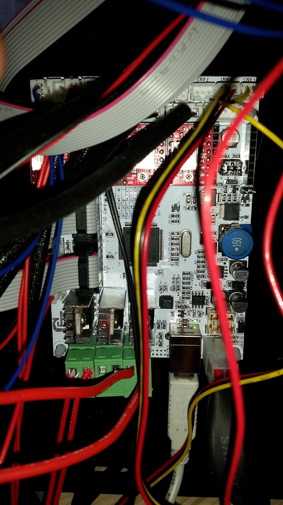

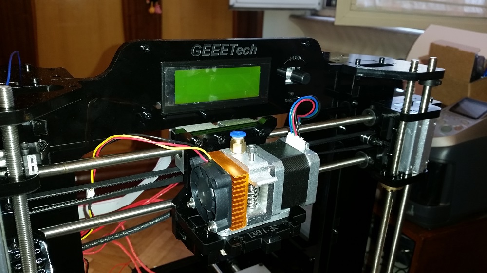

Hi Guys,
I finished to build the Prusa I3X Kit and now I need to know where I can find the firmware (websites) and how to upload it into my Prusa I3X.
Please see my photos in attachment, the LCD doesn't show anything.

I think you have connected the LCD cable to the SD card one, you can swap them see if it works,
And you can refer to the link here to check it:
http://www.geeetech.com/forum/viewtopic ... 13&t=17040
And download the firmware here:
http://www.geeetech.com/forum/viewtopic ... 10&t=17046
