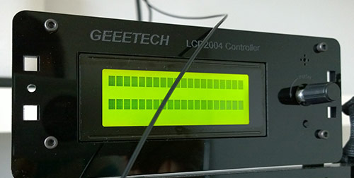

My prusa i3 pro C has stopped starting up. LCD panel shows only two rows of black bars and the reset button doesn't work.
- I have tried to connect to the printer via repetetier and octoprint
- I have tried to turn it off and on again :)
- LCD panel shows only two black bars
- I have tried to use the reset button

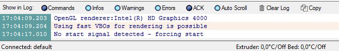

I have attached an image of the lcd screen and a message repetetier informs after connecting to the printer.
How I should proceed in solving this problem? :)

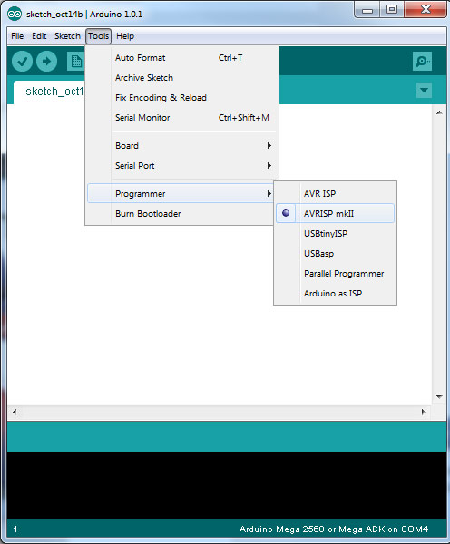

If I however choose a programmer AVR ISP and then select upload using programmer it will return with a following error: avrdude: stk500_getsync(): not in sync: resp=0x00
attachment: should I use progammer and if yes, what one? I have tried using them all but AVR ISP seems to give most promising error message (others just say that there's no device connected)

Hello I have not had any luck in solving my problem with the prusa i3 pro C not starting up.
Friend suggested to use the bootloader method in uploading the firmware. Is this type of uploading possible?
And if yes are there schematics for the GT2560 board how to connect wires for the bootloader method?
Bootloader method
Bootloader method
Mark
Posts: 1553
Re: Prusa i3 pro C - dual extruder not starting up
Post by Mark »
There's no pin on the board available for you to connect to upload the bootloader, I think you can contact the seller to have a new board.
