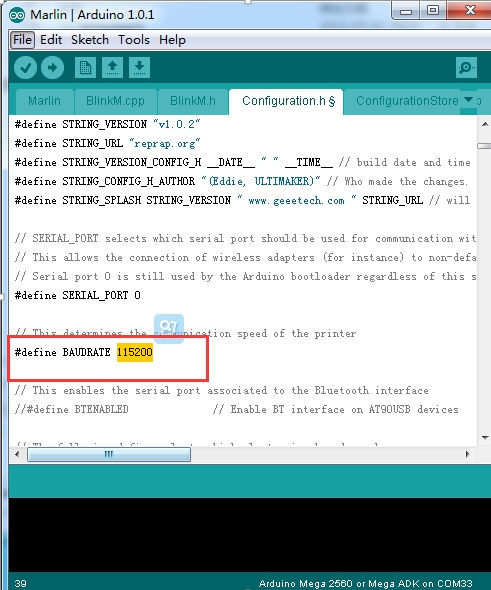

In fact ,there is no difference between burning firmware in Win OS and Mac OS.Just change baud rate from 250000 to 115200 in configration.h .In repetier host ,the baud rate should select 115200 as well.
