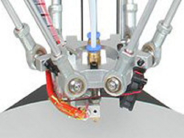

I have assembled and tested my G2S Pro, everything works fine with the exception of the Hotend fan is there a command I can send to test the fan functionality ?
hotend fan.jpg (49.02 KiB) Viewed 3974 times

You can use M106 S 100 to check it.
refer to the link here:
http://www.reprap.org/wiki/G-code#M106:_Fan_On
