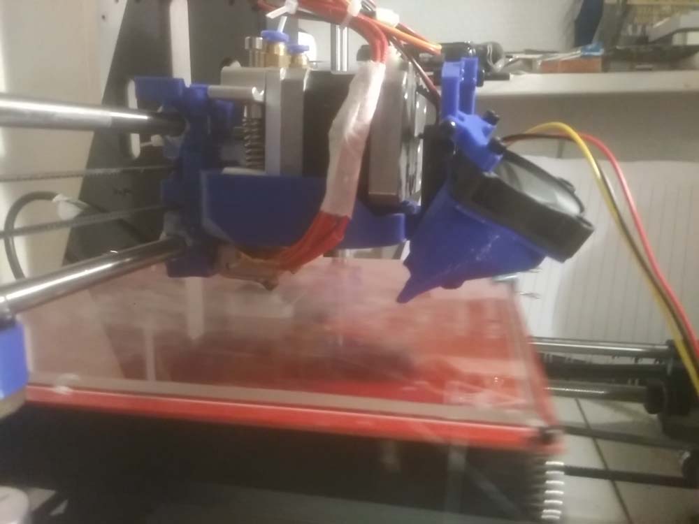

Re: Geeetech Prusa i3 pro c dual extruder question
I confirm, it's ok for that.
But it miss a fan to cool the plastic when it goes out.
It buit it and pieces are better. But i didn't find a good model on thingiverse, I think I can improve my installation.
- works better ;)
Hi cedrij,
Thank you for your reply. It looks ok. Could you share the 3d model?
Best,
RMRodrigues
Best,
RMRodrigues
No problem, i found this : http://www.thingiverse.com/thing:758455
I am trying to make a good one on ScketchUp, but I'm not a pro and it's not a finished version ^^
I'll tell you when I'll finish
