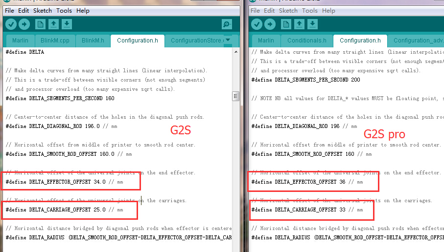

And have you installed the new firmware for your upgraded G2S? download it here:
http://www.geeetech.com/forum/viewtopic ... 10&t=17046
And note the difference between the G2S and G2S pro, see the picture below.
If you upgrade one of them , then change the upgrade setting. And if you upgrade both of them, change them both.
