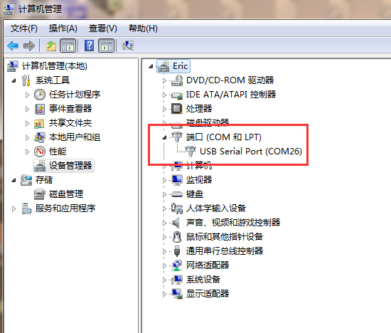

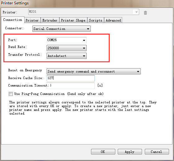

Did you select the correct baud rate? and how's your COM prot here?

Yes, on the Win 7 and Win 10 laptops I see that same thing posted in the two pictures you sent. When trying to update the firmware, I get the same "access denied to Com port X" after compiling using the Arduino app. I bought a new Win 7 laptop today, and just tried it, and I was able to connect and perform the firmware update successfully! So, I think I'm good now!
