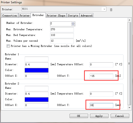

In addition your slic3r settings are not correct, you can refer to the attachment to check it, it's for PLA, using repetier host1.5.6.
Also your printer settings is 200*200*180, not 100*100. the offset for your nozzle is -16 and 16, you can set it here:
I3 pro C repetier1.5.6 config.zip
