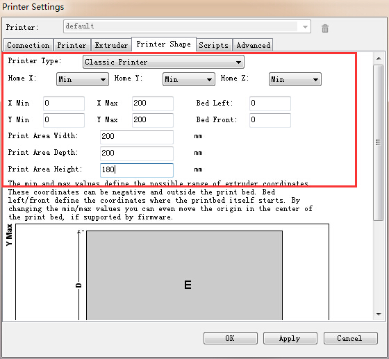

The offsets are set for a printed 50mm larger than that of the mecreators 150mm. Is that correct?

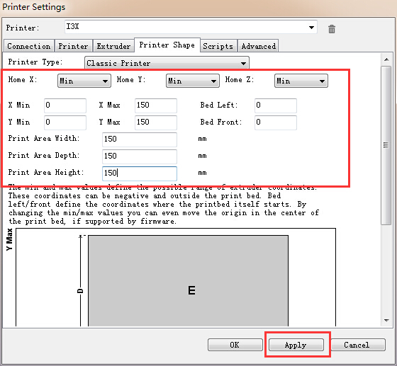

Re: Extruder Positioning
the picture is from my I3X and just for your reference, you need to use 150mm for mecreator.

My settings are exactly the same
No need to reinstall the firmware, just change it and apply it.

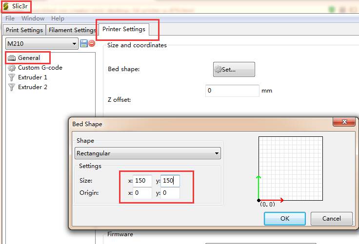

Ans remember to change the slic3r settings here too:
Tried adjusting the Repetier host settings and the Slic3r setting. Notice that after changing the values from Max to Min, it reversed the motion. Now instead of having the travel problem on the X axis, it changed over to that of the Y axis.
