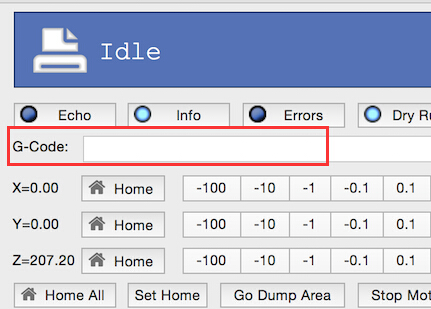

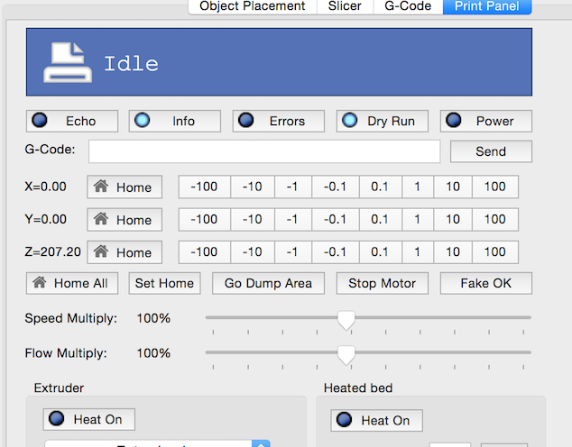

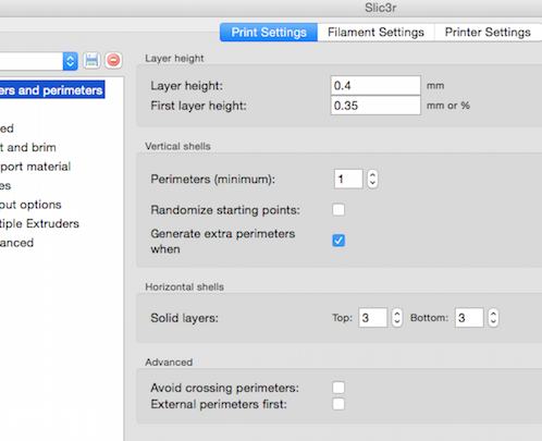

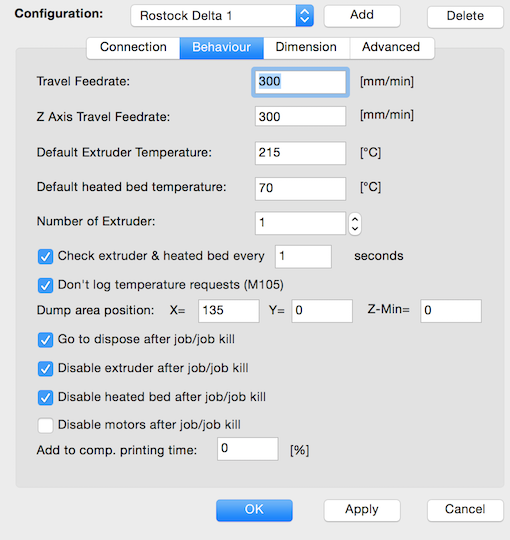

first question. how do you manually calibrate (without the probe) how do you make the printer head go to the three outer points so that i can check if it's leveled coz i don't have a similar window in repetier host for mac?

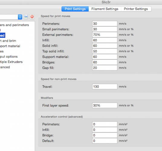

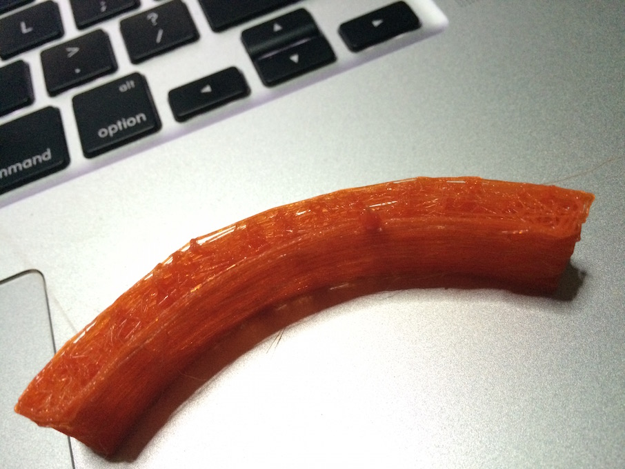

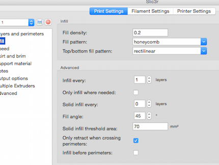

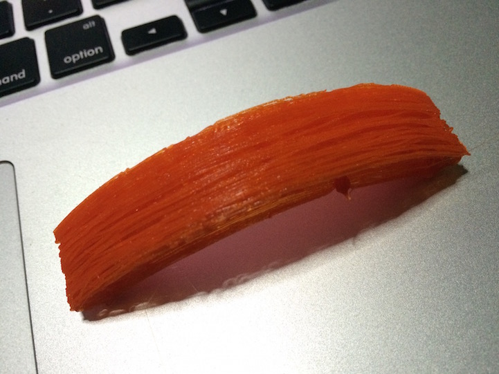

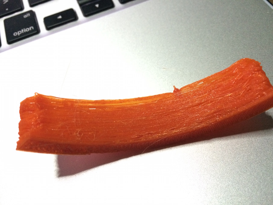

2nd. im getting prints like this. what am i doing wrong with these? my print head is 215 and my bed is 70. am using Esun PLA. i think my print speed is too fast. where do i change that?

my settings for print speed

what i see in repetier host

guess you need to check this post here:
http://www.geeetech.com/forum/viewtopic ... 26&t=17183
“ i don't have a similar window in repetier host for mac? ”
I think you need to manually enter the commands here:

Thanks @ mark. i finally figured it out. there was something wrong with my settings at slicer.. the link helped a lot. question tho. im afraid i might burn the hot end soon. does this hot end perform good or what hot end performs the best?
