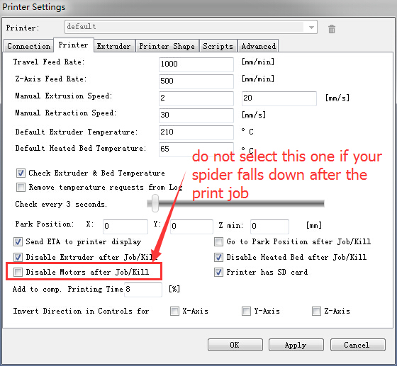

uh...you can manually move the Z axis now and then to keep it busy I think.
And maybe set it here:

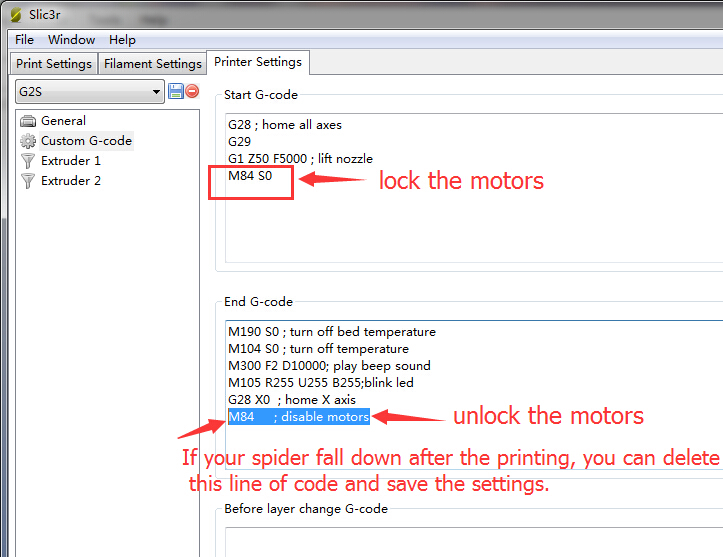

Mark
Posts: 1553
Re: G2S Pro Motor timeout / Head dropping
Post by Mark »
I just find out another way, you can check it here:
http://www.geeetech.com/forum/viewtopic ... 519#p28519
