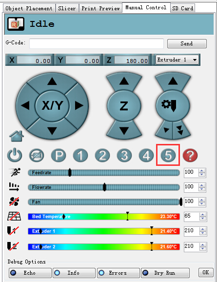

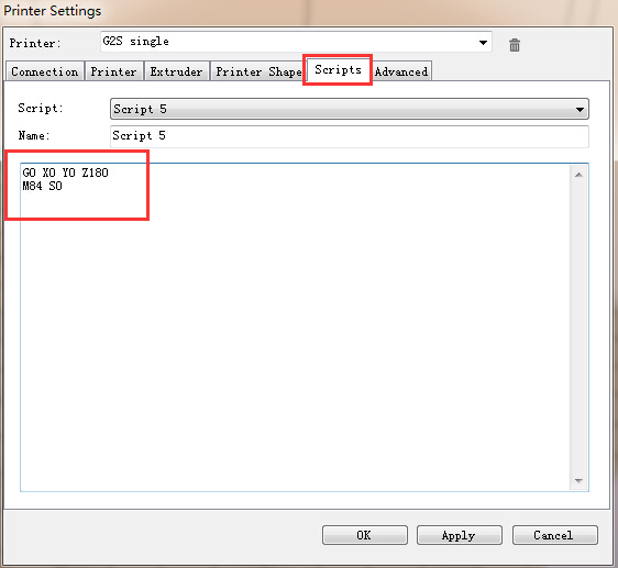

you can try this: add "M84 S0" behind any command in the scripts, and every time after you home the printer, click the script to move it to the position, then it won't fall down again.
(you can change the command to the 3 coordinates when doing calibration)

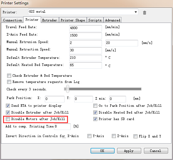

And remember to uncheck the option below:

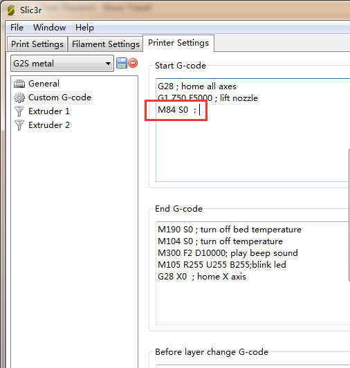

also add a "M84 S0" here:
