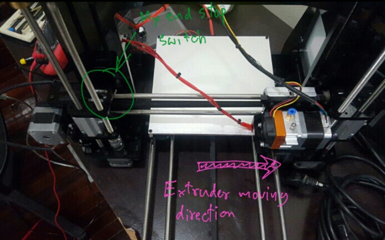

I found another problem. It seems to me that X axis was going to wrong direction. When I do the homing, extruder will move away from end stop switch. I install end stop switch on the linear guide at the left side according to the instruction manual. What did I done wrong? Can I just swap the end stop switch to another linear guide side (to the right side)? Will it mess coordinate system of printer and software and result to wrong printing?

Re: My Z axis does not move..!!
change the direction as the link shows:
