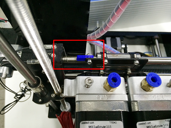

Hello guys, some customers who bought I3 pro C might run into this problem: the X carriage is too short to trigger the endstop!

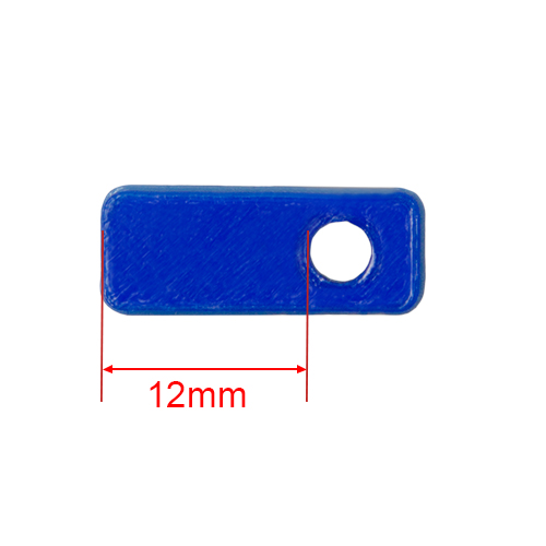

Don't worry, I'll give you a solution here: add a printed plastic trigger to the X carriage and you can solve it. Or you can find something similiar to replace it too.
Check the picture below:
We'll provide the endstop trigger in the kit from now on, so you needn't to worry about that if you want to buy it these days, thanks!

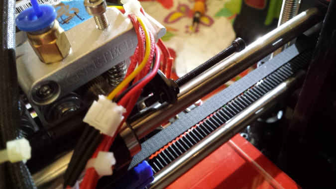

I have what I think is the same kit and had the same issue. I used a small bracket from a Make: Robotics kit that I had and bent it to fasten and hold a 50mm screw locked in place with 2 nuts & washers. Here's mine:
Geeetech I3 Pro C X-axis Extension.jpg (54.81 KiB) Viewed 27461 times
