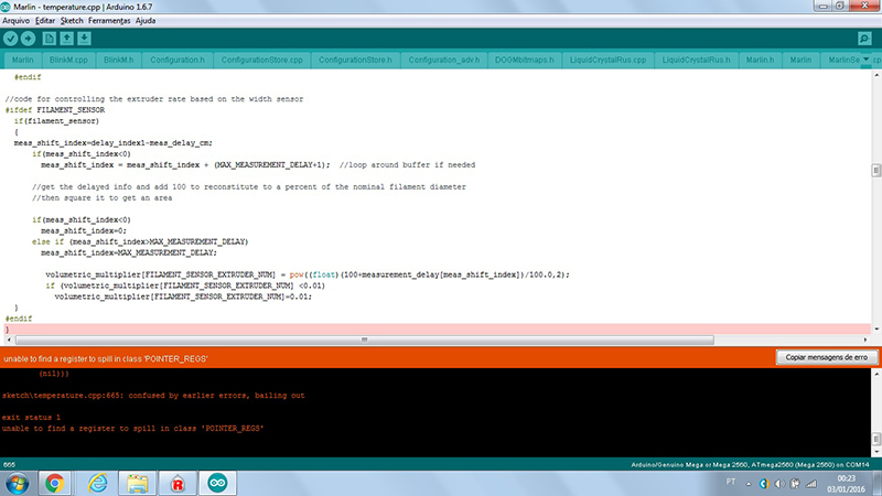

When sending a print job checked that the extrusion is retracting the filament. Carrying out the test in Repetier-host: extrude = retract and retract = extrude; I tried to compile the firmware (Marlin-PI3_Pro_C) and had an error:
exit status 1
unable to find a register to spill in class 'POINTER_REGS'
Please help!

try to use the arduino1.0.1, it's more stable, the latest arduino always has those problems, download it here:
http://www.geeetech.com/forum/viewtopic ... 20&t=17181
