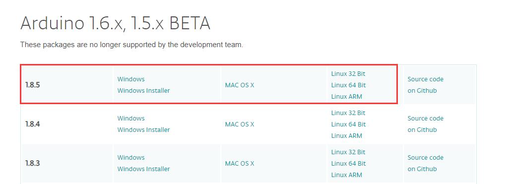

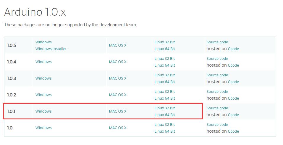

1. Install Arduino on your PC.
If your printer is A10/A10M/A20/A20M, please use Arduino 1.8.5 to finish the upload;
If it is Prusa I3 Pro B/W/X/C, please go for Arduino 1.0.1!!
Otherwise, you might get some bugs during the verifying.
Download Arduino 1.0.1 or Arduino 1.8.5 here:
https://www.arduino.cc/en/Main/OldSoftw ... s#previous

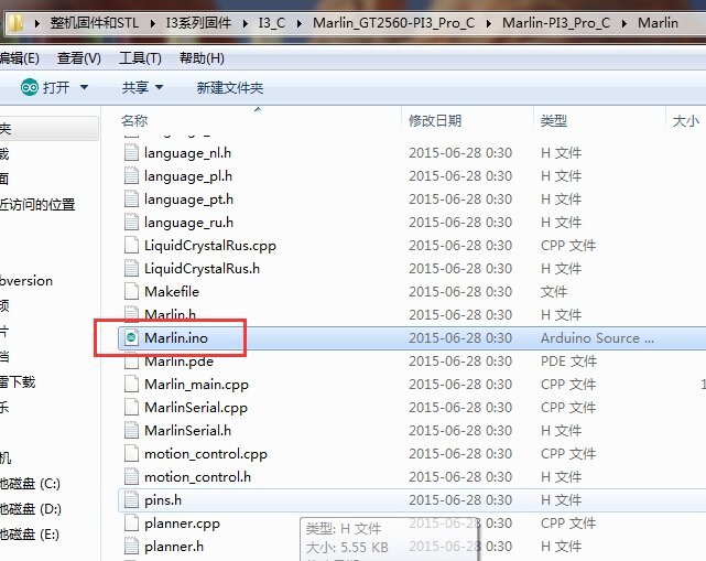

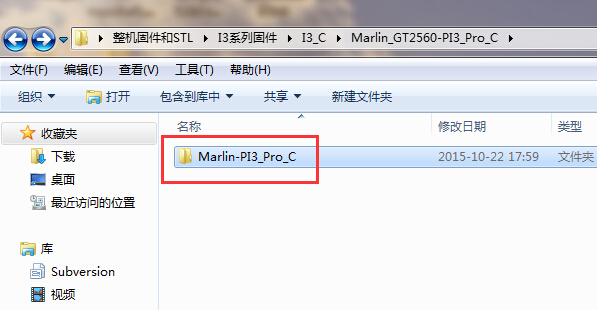

3. Unzip the firmware.
Here we take firmware for I3 pro C dual extruder for example.
The process for A10/A20 series is quite similar, except the Arduino in a different version. Also, this video shows you the example:
https://www.youtube.com/watch?v=o1QKSgnk_ig
You can download the one for your printer here:
http://www.geeetech.com/forum/viewtopic ... 10&t=17046

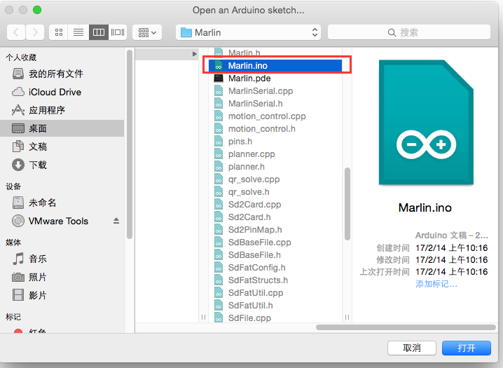

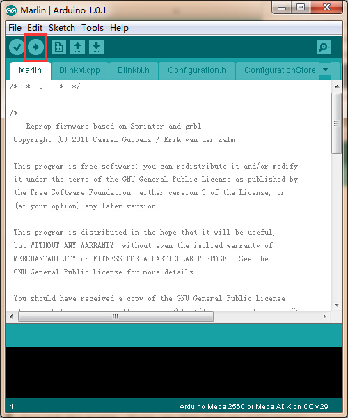

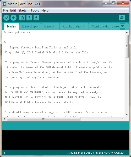

4. double click the Marlin.ino, then you'll open the whole firmware in the arduino.

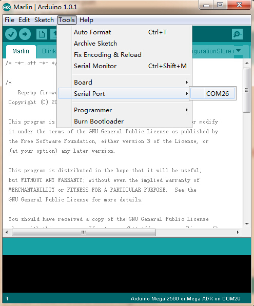

5. Select proper Com port.

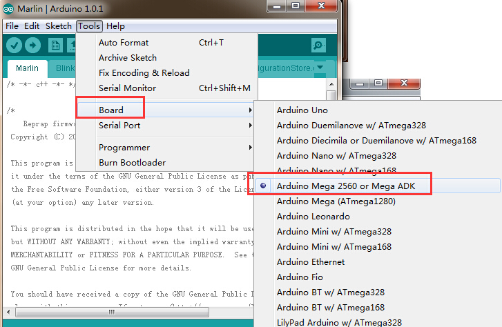

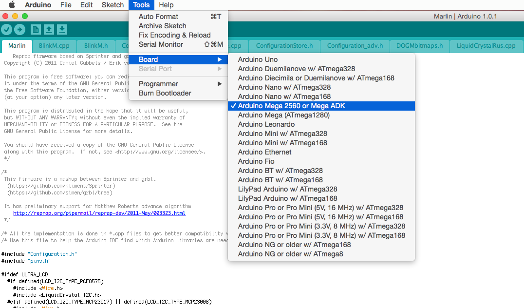

6. Under Tools, in Board, select Mega 2560 .

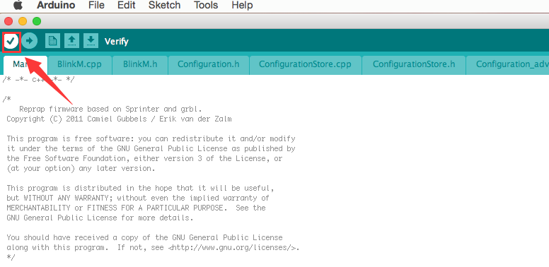

7. Finally click the arrow to compile and upload the firmware to your printer.

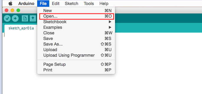

If your PC is MAC(OSX sierra or more high version)
1.Refer to this website at first
http://osxdaily.com/2016/09/27/allow-ap ... atekeeper/
2.Then check the flash of the mainboard,refer to:
http://www.geeetech.com/forum/viewtopic ... 974#p81974
3.Download Arduino 1.0.1
4.Other steps are same as the Windows system method
