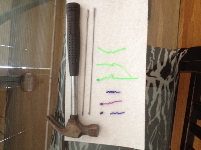

Post by ric chin »
trapaing tools.jpg (101.92 KiB) Viewed 16857 times
Must have tipaning tools...for the heads on your M201....
