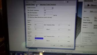

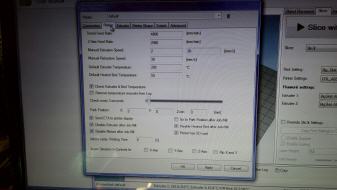

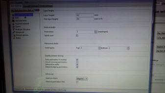

Here are pictures of some of my screens and the object:
ABS Adhesion and Corner Lifting

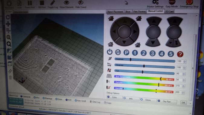

- Repetier Screen
- Repetier Screen.jpg (45.3 KiB) Viewed 18087 times
- Printer Settings - Printer
- Printer Settings- Printer.jpg (9.99 KiB) Viewed 18087 times
- Printer Settings - Extruder
- Printer Settings - Extruder.jpg (9.08 KiB) Viewed 18087 times

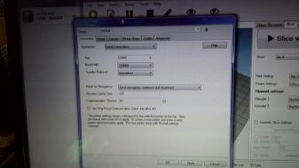

- Printer Settings - Printer Connection
- Printer Settings - Connection.jpg (8.63 KiB) Viewed 18087 times

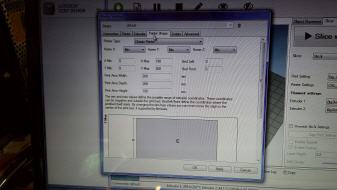

- Printer Settings - Printer Shape
- Printer Settings - Printer Shape.jpg (10.36 KiB) Viewed 18087 times
- Print Settings
- Print Settings.jpg (7.99 KiB) Viewed 18087 times

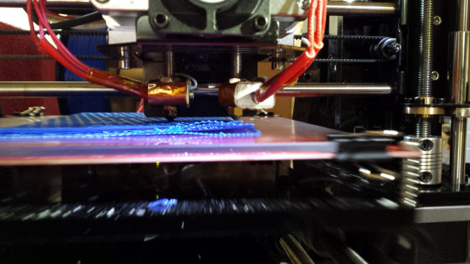

- Object Lifting
- Object Lifting.jpg (48.84 KiB) Viewed 18087 times

How about change another object? this one is too big and thin, easy to bend...or reduce the distance between the nozzle and bed, see if it works.

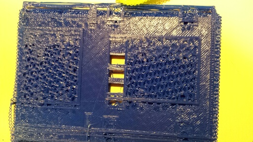

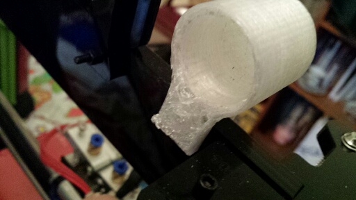

My next idea for looking at this problem is the poor quality of the bottom of my prints. I didn't mention this previously because my main issue was keeping objects stuck to the glass. I felt that general appearance could be dealt with later.
Please see the attached images and tell me if you think that the quality of the bottom side of the prints might have something to do with the adhesion issue that I'm having. I have high hopes that you or someone might be able to shed some light on the problems I'm having. Everything was printed with ABS.
Please let me know if any other information would be helpful.
Again, I thank you for any and all of your assistance.

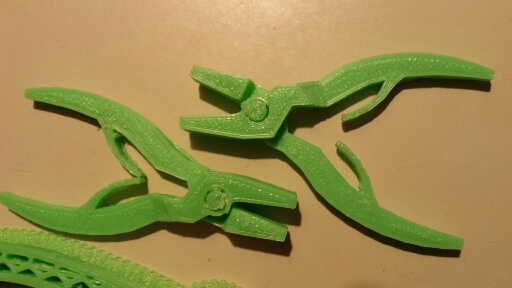

- This is a filament guide that I successfully printed two of in separate prints from each other. I wasn't thrilled at all with the quality, but they function quite well as is.
- Filament Guide_Successful.jpg (49.43 KiB) Viewed 18056 times

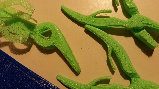

- These pliers were successfully print,viewed from the top however. The pivot points are too tight, but again, I feel that this would be another issue to deal with later.
- Pliers_Successful_Prints.jpg (46.62 KiB) Viewed 18056 times
- Here is a mix of success and failure. The single left hand piece came loose from the bed.
- Bottom_of_Pliers_-_Left_Failed.jpg (66.1 KiB) Viewed 18056 times
- This is the bottom of the print from the previous post. It shifted on the bed before loosening.
- 100X150mm_Chassis_Shifted_&_Came_Loose.jpg (90.78 KiB) Viewed 18056 times
