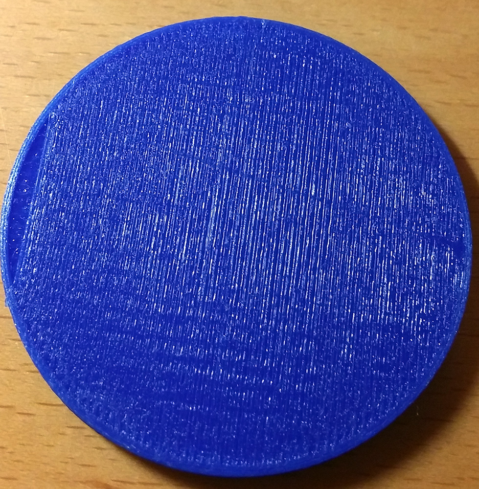

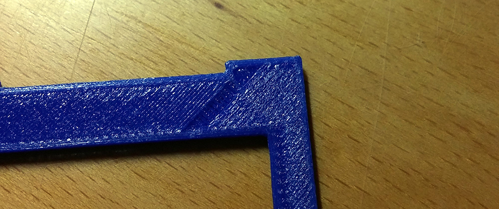

Hello,
My prints are kind of OK but in the last layer the printer finishes printing before completing printing the whole layer
as you can see in the photos below
My printer is i3 Pro B and I'm using the slicer configuration as in the instructions
How to solve this problem?
Thanks.

how's the slic3r? could you see the same thing in the preview window?
24ariel3
Posts: 21
Joined: Sun May 24, 2015 10:03 pm
Re: not completing printing the last layer
Post by 24ariel3 »
In the slicer preview I see the full complete model
Mark
Posts: 1553
Post by Mark »
...doesn't make any sense. Is the dimensions of your object correct?
24ariel3
Posts: 21
Post by 24ariel3 »
Yes they are :|
Mark
Posts: 1553
Post by Mark »
uh...can't figure out what's wrong:( maybe you can use the default slic3r settings to test it or use cura.
24ariel3
Posts: 21
Post by 24ariel3 »
Looks like updating from to 1.6.0 fixed the problem :)
