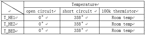

(2)Make the T_HE1, T_HE2 and T_BED open circuit, short circuit and plug 100k thermistors on the three sockets. Checking if the corresponding temperature is normal. You can refer to the post
http://www.geeetech.com/forum/viewtopic ... 23&t=17030 The normal situation is as below while the hot ends and hot bed cool down.

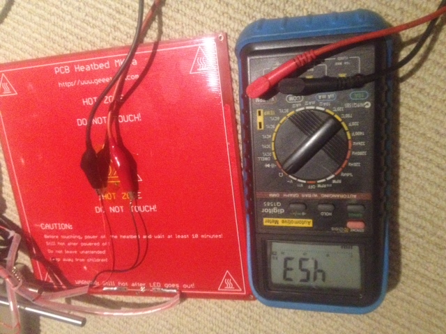

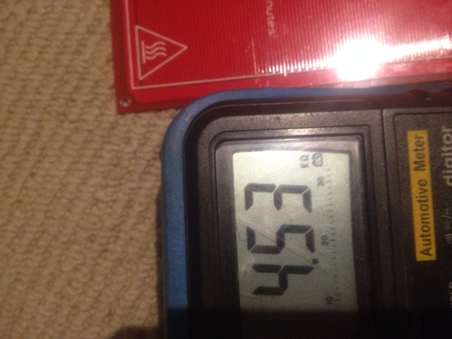

2. I retested and applied a little more force to the connection, attached should be the picture of what I was asking. I now have a reading and it is shown in both cases on the multimeter within each picture. Thermistor appears to be 4.53K ohms.
According to the Geeetech instructions/pictures of the printer on page 36, the wires for thermistor of heatbed are the thinner gauge wires and connect with a pre-fabricated clip (not the screw in items that are called heating wires for heatbed, as pictured within the instructions).

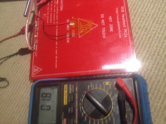

3.Heating wires for heatbed showed 1.8 Ohms, as per photo
