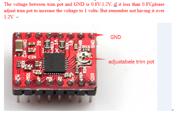

hi, please tune red driver board voltage. increase the trim pot voltage to 1v.

Hey thanks for the reply :D
I check the voltages again and bumped them up to 1.1v each but it didnt seem to help :/
