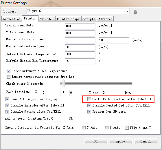

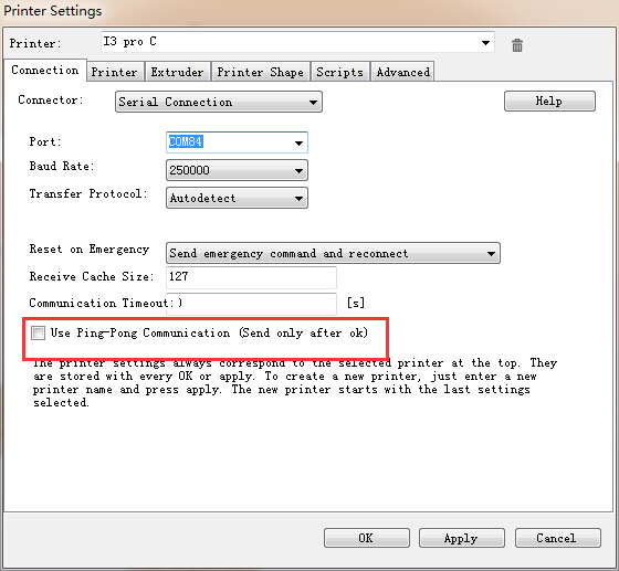

some of your slice settings are not proper, you can download the user manual here to check it:
http://www.geeetech.com/unassembledgeee ... p-927.html
and did you use PLA or ABS? if you use PLA then the temperatures are too high for it, 200 for the hotend and 65 for the heatbed will be fine, seems your object is melted under high temperatures.
and uncheck the setting here, it might cause crash after the print job finished:
Aslo this one here, might cause a delay during the printing:

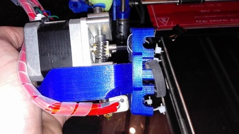

Another problem that i have is a hanging extruder. See the attachment below here( the picture). I have buy metal parts from ebay for this problem. It looks like that the plastic get hot, end go bending. I hope that the problem will fix with this metal parts.
For now i gone try it with your settings..
