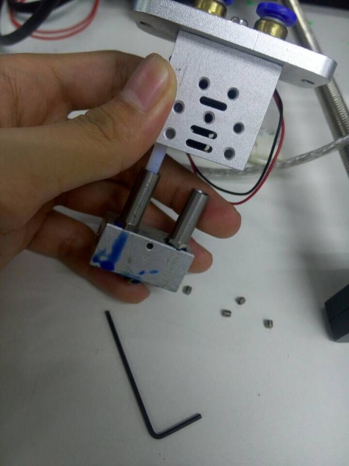

Have you tried this?Disassemble the hotend:
Having same issues here. I seems like you got some filament clogged in the cooling chamber/heatsink part of the hot end. Your best bet is to disassemble the hotend and push out the filament, you will need to unscrew the four mini screws on the back to release the heatsink from the two tubes. There is probably filament cooled in one of those tubes which does not heat up enough to melt due to the fan. Usually this happens when you pull the filament out of the feeding tubes. You might need to heat the extruder without the heatsink on to soften the plastic.
I've unscrewed every little bit of the hotend, just be careful you probably need the hotend hot to even take the parts off because the plastic will keep it in place and you can grind the metal trying to open it.

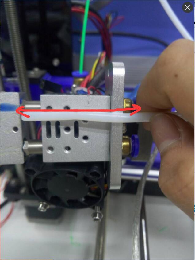

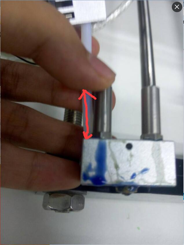

The plugging length should be as long as the red arrow shows:

We see the importance of instructions on how to add the filament and installing the ptfe tube, none of which are mentioned on any of the building guides or videos. In my case, I had already cut the tube to the exact length and now that it should go 4 cm more deep it is just not enough long.
