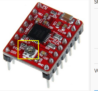

Besides, the voltage between potentiometer and GND is 0.8V-1.2V. if it less than 0.8V,you should increase it by tightening the potentiometer(screw)
Symptoms of not enough current are skipping steps and poor microstepping linearity. Too much current will cause the motor or the driver to overheat. When the driver overheats it shuts down for a few seconds and then restarts again when it cools. This makes the motor twitch when it is stationary and pause during motion.

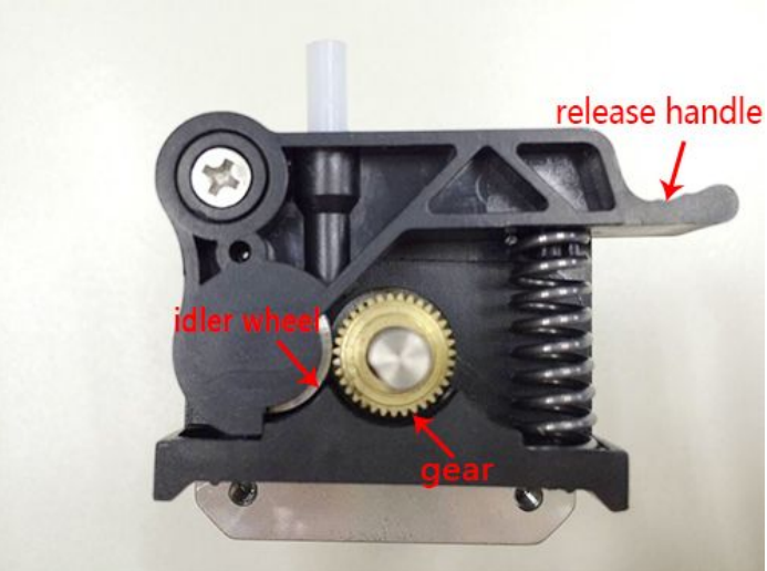

If the extruder motor can rotate, but hear click noise or the extruder motor move in a narrow range. In this case, please check whether the gap between idler wheel and gear are too large and the pressure is too small to drive the filament. you can refer to this link.
viewtopic.php?f=19&t=18507

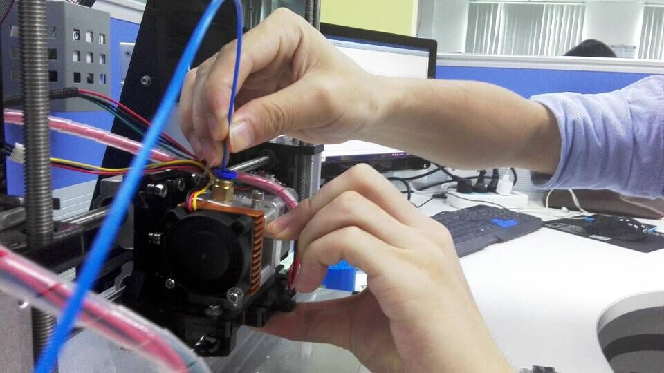

If the nozzle is clogged indeed, please clean it with drill(needle).
1. Stopping the nozzle with repetier host, then move nozzle away from printing object.
2. Heating extruder (PLA190°-210°,ABS 230°-250°),pull out filament from nozzle to prevent further clog.
3. Remove the cold end, just leave the nozzle.
3. Clean surplus jam with the needle, please be careful and gentle as there is a tube in nozzle. Please do not damage the tube when cleaning jam .
4. Assemble the fan, heatsink and extruder motor, replug the filament to nozzle.

I need help please, finally my 3D printer is working, but I have a problem with the amount of filament that is been extruded. It is not enogh. There is a significant change if I use my hand to press filament into the extruder. My 3D uses the MK8 extruder, I tried all you explain in this post but the potentiometer adjust. I don't find where the potentiometer screw is. Thanks.
Admin
Posts: 486
Re: Extruder not working
Post by Admin »
geeetech A4988.png (179.2 KiB) Viewed 104502 times
it is here
