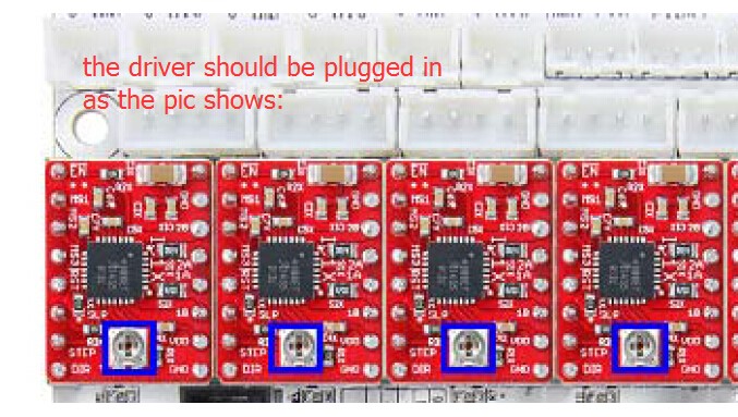

1.2 Check the directions of the step driver. The wrong direction will damage the board!
A4988:
DRV8825:

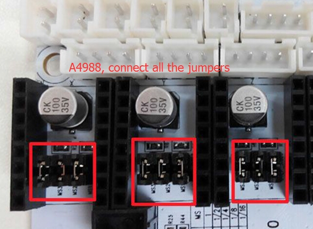

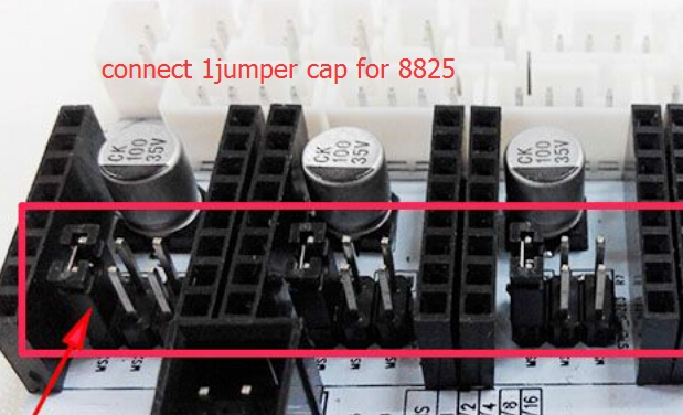

1.3 Check the subdivision of the step motor.
So if you use A4988 and 1/16 step, you should plug in the caps like this:
And for 8825:

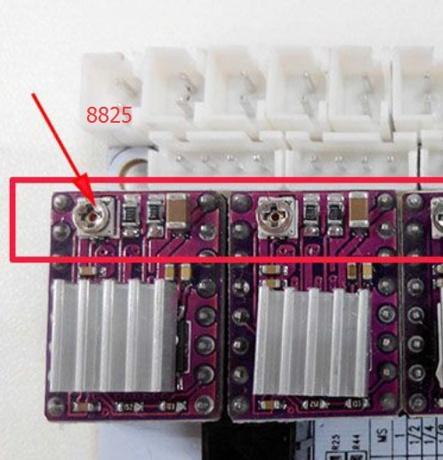

1.4 Check the voltage of the motor driver and the motor connector.

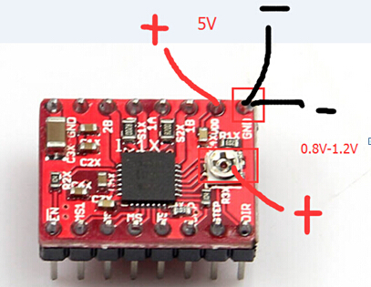

Measure the voltage of the driver board, normally the value should be 0.8V-1.2V, you can put the red probe of multimeter on the potentiometer, and put the black one on the GND.
If the voltage is too low or too high, the step motor will not work stable. It will lose steps or vibrates, sometimes too hot. You can rotate the potentiometer on the driver to adjust the voltage to about 1.0V and see it if works.
NOTE: the voltage between VDD and GND on the driver board of GT2560 is 5V, and on the board GTM32 it is 3.3V.

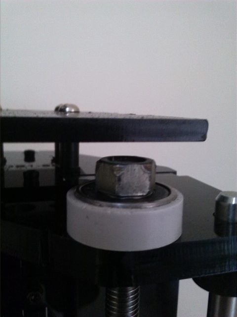

The Z axis stepper motor bearings are carrying a substantial load for such little bearings. The resulting loading is a problem. I overcame this problem by modifying the design. I fitted two rs608 ball bearings to the upper ends of both Z axis threaded rods and nuts above the bearings to take the full weight of the load. Now the universal couplings on the Z axis motors are under tension (not compression) forces and the stepper motors are as a consequence carring no weight at all!!. Both Z axis motors now work like a dream. See image below. Note: the bearing housings are not fixed to the acrylic but float and thus are self aligning. The housings are just PVC electrical conduit whose purpose is to ensure that the bearing centre doesn't come into contact with the acrylic parts of the printer. I skimmed the inside diameter of the conduit to fit the bearings against a PVC conduit shoulder for this purpose.
Load support bearings for Z axis rods. Note the nut screwed to the threaded rod supporting the weight through the bearing?
IMG_20151028_081217 (480x640).jpg (121.24 KiB) Viewed 104977 times

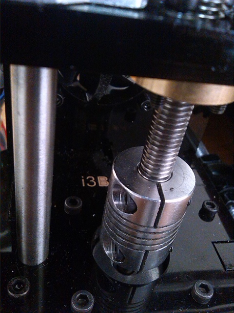

Also, the Z axis threaded rods are a poor fit in the universal couplings. This causes ungainly movement and a further unnecessary workload onto the universal couplings with a resulting knock down effect of increasing the load on the tiny Z axis motor bearings still further. To rectify this problem I machined about 6 mm of one end of both Z axis threaded rods and fitted sleeves to both threaded rods, each with holes for the grub screws to go through to lock the universal coupling directly to the rods. See image below.
Sleeved lower ends of Z axis threaded rods.  Note machining of threaded rods, to extent of thread removal at ends, was necessary to fit sleeves.
IMG_20151028_081331 (480x640).jpg (211.74 KiB) Viewed 104977 times
I have made several other absolutely necessary design changes that are unrelated to the Z axis performance. My Geeetech Prusa I3 Pro X now works like a dream. I'm very happy with my results so far.
