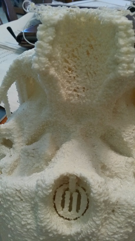

I had a skull print runing (about 16 hours worth according to Repetier-host) when it was getting higher in the Z axis it started acting up . I made a movie but unable to attach it to post.

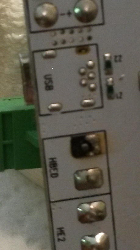

When I went back it took several tries to get Y axis to move correctly, but the heatbed just would not heat. So I checked the resistance of the heatbed and got 2.5 ohms between black and red and 0 ohms between black and black and 0 ohms between red and red, not sure but from what I've read 2.5 ohms might be a high reading.

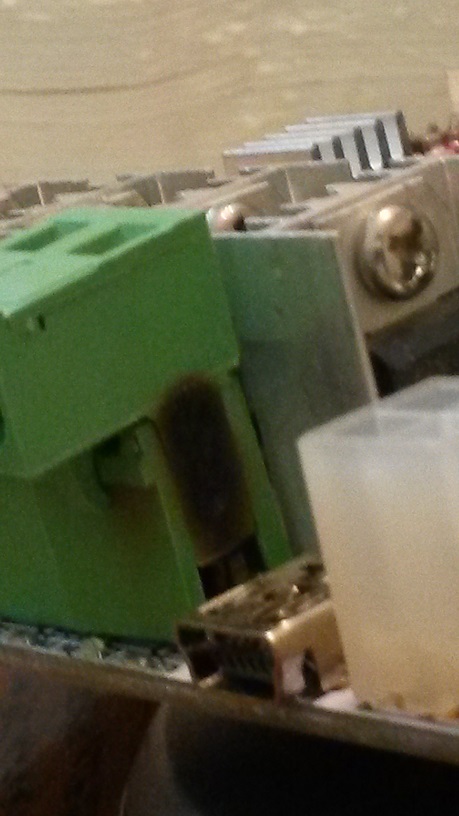

when I tried to disconnect the heat bed from the control board ,the green portions of the connector would not seperate from each other, so I had to dismantle the control board from the printer.
I could then see that the side of the connector was burnt and the solder to it on the bottom side of the board was also burnt away. Pictures attached !

In fact, the hot bed part on board is easily to brun out, you'd better not do a long time printing job.

Usually we don't print over 10 hours.
