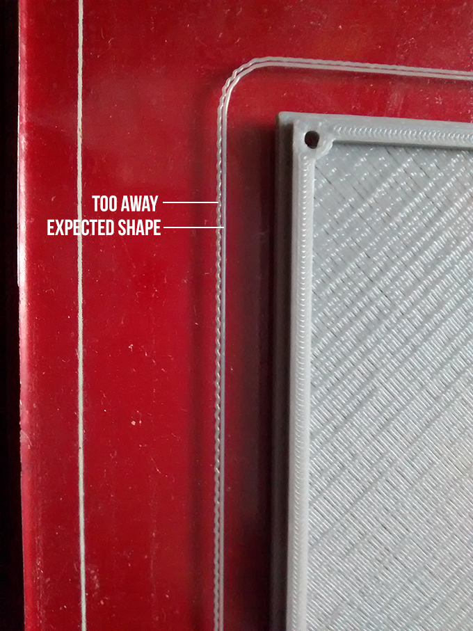

Sorry for the delay, as you said mark the problem was the nozzle too close.
After testing and testing I realised when the nozzle is too close and when is too away.
I'll attach some pictures when the nozzle is too away, and will update (soon)other when is too close
