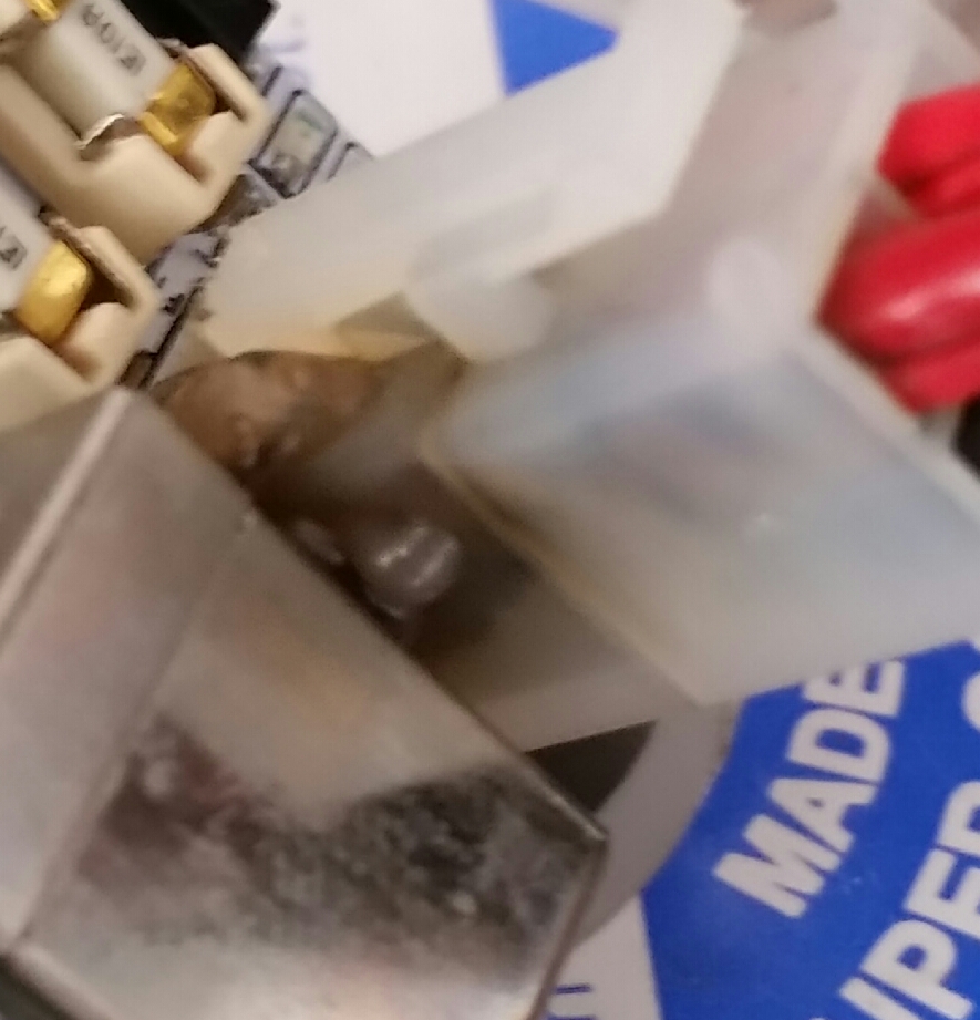

judarc
Posts: 2
Joined: Fri Feb 12, 2016 10:01 pm
Re: GT2560 burnt heatbed socket
Post by judarc »
Hi, the same thing to me, but today the damaged was on the main DC power plug, I plan to solder the cables directly to the PCB and see if they don't get hot as soon as I turn the bed on.
After burning the green plug once, now this happened
