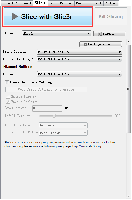

The display works and the axles are functioning correctly, but the printing problem still hasn't been solved. When I import the item I want to print, connect the printer, and press print, it goes to a screen saying "Printing complete". The items disappear when I switch pages. Is there a bug or is it something to do with me building it incorrectly?

Hello,my friend
It's my pleasure.
You mentioned your printing problem,i guess you have missed this step,haven't you?
